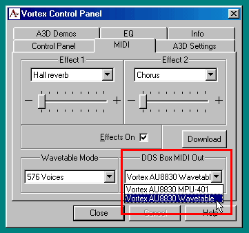

The only windows soundcard driver I know, that directly allows selection of all midi synths for use in DOS is the one from the Vortex 2 (PCI). As you can see here: Aureal Vortex 2 MPU-401 / external midi woes (Just that it fails to handle the Music of the game TIE Fighter properly)

I mean this:
AU8830 Windows 9x Driver README.TXT This is the Vortex AU8830 Windows 9x driver version 4.06.2046 .... C. DOS BOXES Windows DOS […]
C. DOS BOXES
Windows DOS boxes are launched from the "MSDOS prompt" in the Windows 9x Start menu. Simply run the game as usual. The game still needs to be configured for the Vortex hardware settings.
Vortex provides wavetable support in DOS boxes if the game supports General MIDI output. To use wavetable in a DOS box:
1. Open the Vortex Control Panel MIDI tab.
2. Ensure that "Vortex Wavetable Receives DOS Box MIDI" is selected.
3. Open the application in a DOS box. Configure the music to use MPU-401 output. The Vortex drivers can also send MIDI to other software wavetable or external MIDI devices installed or attached on your computer.
5.92 KiB
1582 views
IIRC any windows midi synth was selectable there, and it was a great feature. Unfortunately I can't verify any such things currently...
Suppose it will get more complicated if the YMF719 is there together with the Vortex 2 DOS emulation. I did not mention the Vortex 2 as a solution to your problem, just that it does what you want the YMF719 to do.
