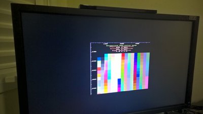

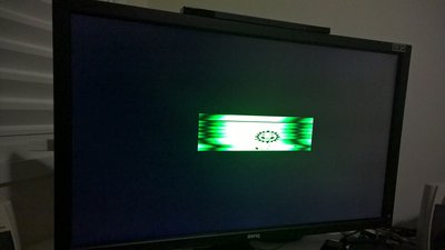

Reply 20 of 69, by alexanrs

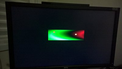

My monitor didn't do too badly...
Monitor:    BENQ 2420T
Native res: 1920x1080 120Hz
Scaling: Interpolated / 1:1 selectable
Aspect rto: 16:9, letterboxing supported
Machine: Pentium 133MHz + Windows 95 OSR2
Video card: S3 Virge DX 2MB (BIOS Version: 2.01.07)
UniVBE: no
Tested by: alexanrs
OVERALL COMPATIBILITY RATING:
13.5 / 14 - Good
Application P F CP Notes
| Ambience | | | X | Displays "Out of sync" message, but it can |
| |###########| be forced to display the image by setting |
| |###########| a shortcut to 1:1 scaling and pressing it. |
| Luminati | | | X | Same as above. |
| Timeless (56Hz) | X | | | Auto-adjust doesn't center the image well. |
| Timeless (60Hz) | X | | | |
| Dowhackado | X | | | |
| Kukoo2 | X | | | |
| Copper | | | X | It trembles... but doesn't wobble |
| Sunflower | X | | | |
| Yo | X | | | |
| Impulse Tracker | X | | | |
| CubicPlayer 132x43 | X | | | I'm not sure the entire screen is showing |
| Tweak 256x256 | X | | | |
| Tweak 360x480 | X | | | |
| Tweak 376x564 | X | | | |

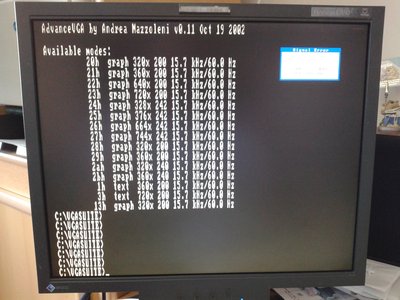

| PAL-on-VGA | | | X | Actually displays the image, but the "Out |
| NTSC-on-VGA | | | X | of sync" message keeps popping up |
| |###########| Also, it displays previous content. |
| Other notes: |
Hopefully the fact that it does display stuff in NTSC-on-VGA and PAL-on-VGA means that it will accept 15kHz signals (e.g. CGA coupled with a simple RGBI to RGB circuit), so I can use it with my XT. Fun thing how it can be coherced to show images after it throws a fit. This monitor has this weird "sidekick" thing with shortcut buttons, and if you set a mode there, and press it, it shows the image where before would only be a black screen with the "out of sync" message. Btw any scaling other than 1:1 caused Ambience and Luminati to display garbage.
Here are some random pics:

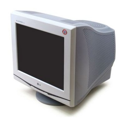

LG FLATRON F700B 17" CRT
29.29 KiB
3142 views
[code]
Monitor: LG FLATRON F700B 17" CRT
Native res: 1280x1024
Scaling: CRT
Aspect ratio: 4:3
Machine: Pentium 233 MMX
Video card: Cirrus Logic 5446 2MB
UniVBE: No
Tested by: James-F
13.5/14.
Fantastic.
| Ambience | X | | | Pass all 83Hz-120Hz |
| Luminati | X | | | Pass all 83Hz-120Hz |
| Timeless (56Hz) | X | | | |
| Kukoo2 | X | | | |
| Copper | | | X | No Wobble. |
| Yo | X | | | |
| CubicPlayer 132x43 | X | | | |
| PAL-on-VGA | | X | | |
| NTSC-on-VGA | | X | | |
| Other notes: |
This one is a keeper.
It will rot at the attic, but I'm not selling it.
EDIT: Just noticed this thread is about LCD. Oh well..

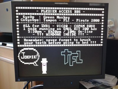

Here are results for my old Eizo FlexScan L550 monitor:
Monitor:    Eizo FlexScan L550 17"
Scaling: Nearest neighbour
Aspect rto: 5:4
Machine: Pentium MMX 200MHz, MS-DOS 6.22
Video card: S3 Virge DX 4MB
UniVBE: no
Tested by: M-HT
11 / 14 - Good

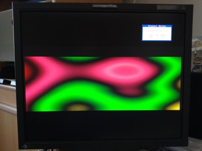

| Ambience | | | X | Displays only a partial image and |
| |###########| complains about signal error - too high |
| |###########| vertical frequency - demo uses 100 Hz by |
| |###########| default and 82 Hz at minimum, monitor |
| |###########| supports at most 75 Hz. |
| Luminati | | | X | The same problem as Ambience. |
| Timeless (56Hz) | X | | | Black bars on top and bottom. |
| Timeless (60Hz) | X | | | Black bars on top and bottom. |
| Dowhackado | | | X | Yellow bar where mode changes mid-screen |
| |###########| and complains about signal error - too low |
| |###########| vertical frequency - demo uses 54.7 Hz, |
| |###########| monitor supports at least 56 Hz. |
| Kukoo2 | | X | | Freezes after few seconds. |
| Copper | | X | | Shows black screen during wobble effects. |
| |###########| Some other effects work, some don't. |

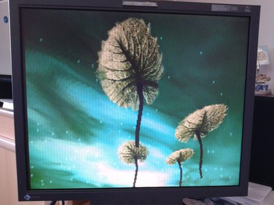

| Sunflower | X | | | The high-colour 'fakemode' looks very bad |
| |###########| compared to 16-bit modes. |
| Yo | X | | | |
| Tweak 376x564 | | | X | Complains about signal error - too low |
| |###########| vertical frequency - mode uses 50 Hz, |
| PAL-on-VGA | | | X | Complains about signal error - too low |
| |###########| horizontal and too low vertical frequency. |
| NTSC-on-VGA | | | X | Complains about signal error - too low |
| |###########| horizontal frequency - mode uses 15.6 Hz, |
| |###########| monitor supports at least 31.5 Hz. |
| Other notes: |
Kukoo2 freezing is probably not a problem with the monitor.
And some pictures:
    1.43 MiB
    3130 views
    NTSC-on-VGA
    2.06 MiB
    3130 views
    Sunflower high-colour 'fakemode'
    1012.96 KiB
    3130 views
    Ambience
