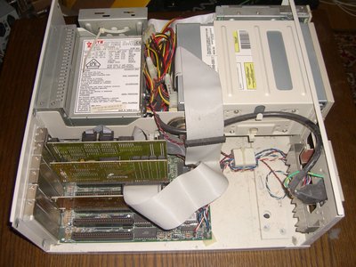

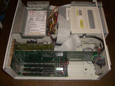

The inside of the system.

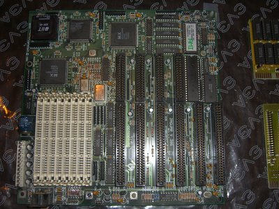

The OCTEK Jaguar V 386 motherboard.

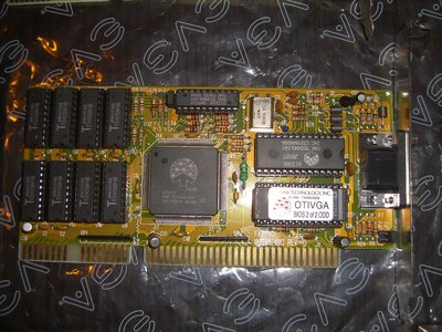

The Oak Technology OTIVGA OTI077 1MB VGA card,

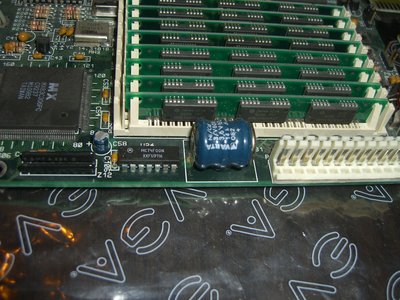

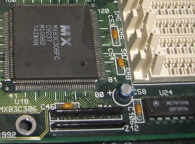

As someone perhaps has spotted the battery is leaking.
4.26 MiB
1469 views
The corrosion damage is really bad.
645.93 KiB
1469 views

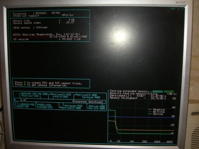

The board does work even with all the corrosion damage. Here is a quick Speedsys with the board outside the case.

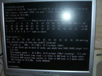

Cachechk. It seems the OCTEK Jaguar V 386 motherboard has 8KB cache memory.

Im wondering if I should keep the OCTEK Jaguar V motherboard or use my Asus ISA-386C as the Asus has more cache memory.

If that's the board the machine with, I would definitely keep it!

Remove and replace the battery, the corrosion only affected the lacquer coating of the mobtherboard as far as I can see. Use vinegar or lemon juice to neutralize the battery acid and the mobo will be OK.

I have already removed the battery and cleaned the board. I used vinegar to neutralize the acid and after I cleaned the board with tap water, to dry the board I used the owen at 75C. 😀

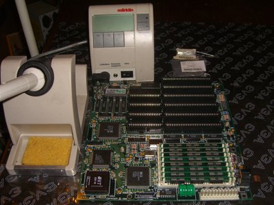

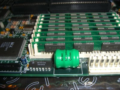

I have now replaced the battery so I can put the system back together again.
The now clean motherboard with the new battery and my soldering station.
4.41 MiB
1395 views
The new battery close up.

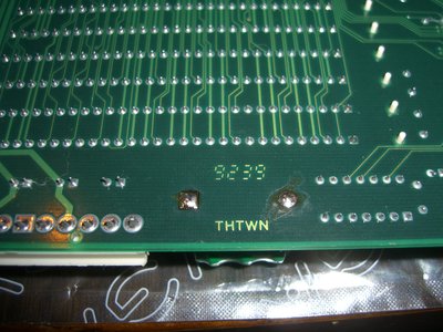

The solder joints.

vmunix wrote:
Only 8kb of cache ? well it's better than nothing, by the way nice FPU and case.
It could be that the highly integrated chipset cache could compensate its small size by having a lower lantency than regular DIP SRAM.

I put the system back together today 😀
The only hardware change is that I removed the CD-ROM controller card and added a Sound Blaster AWE32 CT2760. The CD_ROM drive is an Aztech 2x CDA 268-031SE and it should work with the Mitsumi interface on the CT2760.
[edit] It looks like the "SE" in CDA 268-031SE makes it an IDE drive. The tray would not even open with the drive connected to the Mitsumi interface on the CT2760 so the CD-ROM interface card is back. The system now has 0 free 16bit ISA-slots. [/edit]

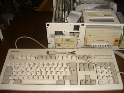

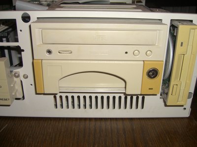

Now it was time to see what kind of HDD the system had so I could set the parameters. A lock! How evil!
3.78 MiB
1222 views
Luckily its not an issue!

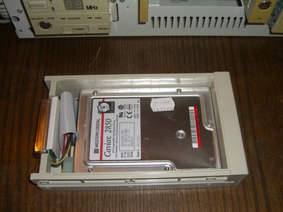

Surprise! It seems the HDD was replaced with a larger one when the CD-ROM drive was added late 1995 or early 1996.

I just got one of these the other day from Germany - I have had 2-3 more in the past, they all seem to come with that drive caddy.
The lock can be easily defeated by removing the enclosure from the bay, then just bending the plastic on the pin side and sliding the caddy out. I replaced mine with a CDROM.
Thanks for the tip, let's hope that works on my colani desktop as well.
