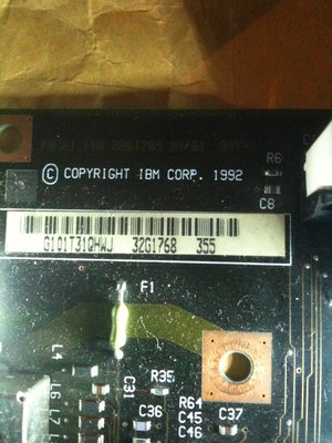

Hi All,
I got my first 386 motherboard setup this week since these beasts were new back in the early 1990's, it's a bespoke IBM 386SX 25mhz board from 1992 on board Cirrus Logic 5410 VGA, FDC, IDE, PS2, parallell & 2 serials on board, even has a coin battery for the RTC 😀

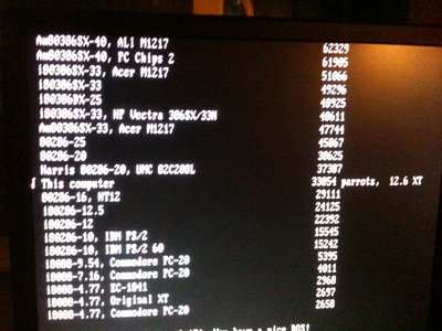

here you go, first time I saw that benchmark.
as to the motherboard model, you know as much as me by looking at the pictures, all i know is IBM 1992.
One of those which shows correlation with Doom. 😀 I run it by: speedtst >result.txt
Your CPU has standard for SX 25 speed there, if to approximate from SX 33.
There are characters in left-upper corner near copyright. May be something useful to identify.

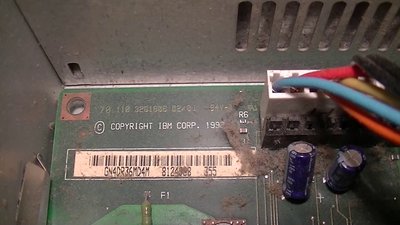

Looks a lot like the board from my ValuePoint... Maybe that is where it came from. Planning on dragging mine out later, so I'll have to take a look at it now. One difference I do remember though, mine has a small heatsink which looks like a stack of metal discs.

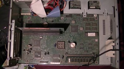

Here are the innards of my ValuePoint 325T/S with the floppy and bone removed;

Inside ValuePoint 325T/S IBM

ValuePoint 325 board markings
Guess your board is a different revision, but for the most part it looks near identical and is the same spec. My CPU gets hotter than hell so you might want to glue on a little heatsink just to be safe.

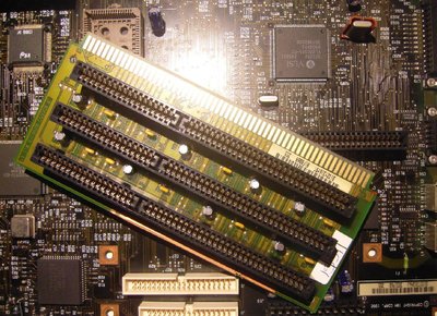

No worries, I was going to mess with this thing today anyway. I have some more info which might be useful, or not, but whatever, here it is just in case;
J12: Near the speaker - If you take the jumper off the two pins, you should be able to use a standard PC Speaker on that jumper. The two jumpered pins redirect the signal to that metal buzzer next to it on the board.
J13: Close to J12 but around the corner - LEDs, should have an asterisk next to it to indicate Pin 1, should be the side nearest that capacitor (C7) - the pinout should be 1-2; Power LED. 3-4 HDD LED. Pins 1 and are positive, the two center pins are ground.
Oddly, my board has eight M5M44900 chips in that corner where yours has four. Not sure of their purpose, look like Dynamic RAM so perhaps the board has onboard RAM. I would test, but I daren't play with that single module I have because the board doesn't play nice with any of the modules I have spare.

yep my board has 2MB onboard & I am using a single 8mb simm unlike the above pics for a total of 10mb.
VERY useful info on the pin outputs, thanks 😀
