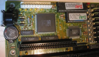

I am attaching a photo of the SiS 85C206 and surrounding circuitry. So that little can oscillator should be connected to the battery? Click image for larger view.

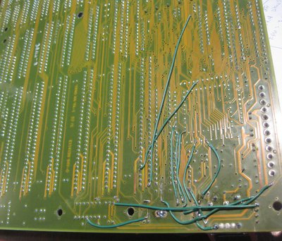

Also attached are images of the past damage done by the leaking barrel battery. A nasty trace repair job. I could not determine where the positive lead from the battery is supposed to go. The can oscillator?

Yes, pictures help bunches. Did not see yet before my last post.
Yes, in the first pic that looks like an oscillator presumably there to support the 85C206.
As I said in the previous post that canned device is just the crystal, not the whole oscillator.
Some of those nearby caps, inductors and resisters are also parts of the oscillator..
You would have to trace out the circuit to find where the battery voltage inputs to the oscillator.
Is not likely at the crystal itself.
I went looking for pics of the board between posts and it appears there are two other crystals on the board in the 'sardine can' style case but those are more likely for something other than CMOS.
Your pics are better than those I found insofar as the part of the board I needed to see.

I have never been able to locate the datasheet for the 206. I did some retracing and the battery goes to a standard rectifier diode, which then splits off to a few parallel destinations - pins on the 85C206, as Vdd to the HEX inverter (MC14069UBCP), and to that resistor which is adjacent to the crystal can and parallel with it. Said resistor then goes to GND. Based on the colour code, the resistor is 1 K-ohm. Instead of this 3 V coin cell battery (which is brand new and measures 3.3 V), I connected 4.5 V and 6.1 V of battery up, but the date seconds still counts very slow. Even with no battery connected, the seconds counting is overly slow.
As I have now traced the battery leads to the 206 chipset, it seems more plausible that either the crystal can is defective or the RTC module inside the 206 is defective.

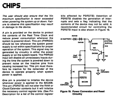

With some luck the 82C206 has a similar pinout:
http://www.elenota.pl/datasheet-pdf/60708/others/82C206
Pin 72 would be the clock input for the RTC. This should go to some output pin on the 4069. A resistor might be in between.
I'd start with the easier to replace parts, crystal, resistor, capacitor. And always make sure there are no invisible breaks in the traces. The battery fluid also eats its way under the solder finish of the PCB, causing breaks in the traces directly at the pads.
1+1=10
Reply 17 of 28, by feipoa
I'm not sure what the changes were between the 82C and 85C, but at least the number of pins are the same. On page 40 of that 82C206 PDF, there is this "Power Conversion and Reset Circuitry" diagram. I believe this, or part thereof, is implemented on this motherboard. From what I measured yesturday, I have that 1K resistor going through a small cap to GND. Where you see the 6 V battery node, the "rechargeable" battery's positive terminal gets connected between those two series diodes, meaning the coin cell battery has about 0.7 V less of voltage drop compared to the EXT BATT. So I'm not sure why the manual calls for a 3.6 V BATT for the rechargeable and 6 V for the external battery. I will try to probe around this motherboard this evening if my kids/wife let me.

Thanks to everyone for their comments. I solved the problem. I ultimately traced out the oscillator circuit and probed it with an oscilliscope. The square wave was at about 5 KHz instead of 32.768 KHz. I replaced the crystal and now the seconds count up correctly.
By the way, that power conversion and reset circuity diagram is implemted on this motherboard exactly as shown. The oscillator circuit uses a 27 pF capacitor in series with 2 inverters in a loop. It then branches off to a 3rd inverter before heading to pin 72 (OSC1) of the 85C206.
The power-up amplitude of the oscillator circuit is 5 V, while the power-down amplitude is 3.3 V, which is the current emf of the coin cell battery. Hopefully a single coin cell is sufficient, otherwise I'll need to stack two in series.
