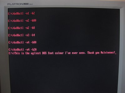

I have this DOS program which I need to run in my autoexec.bat. The program changes the DOS font colour from the standard white to reddish pink. How do I change it back to the default white? Ideally, I would like to put a program in the autoexec.bat which changes the font back to white. I am using MS DOS 7.1 as part of the Windows 98SE installation.

Try "mode co80", if DOS 7.1 includes MODE.COM as came with earlier DOS versions. This resets the video mode and should return the palette to the default.

Since you don't want to change the color but to restore it, there is no need to go through any of these. What we used to do for such programs back then was to run the mode.com command to reset the display to the default rows/columns which also restores the default color. You can add it as the last line of your .bat.
I can't remember the syntax, if you don't find your way around I can search it for you. It was like something mode con 80...

mode c080 saved the day.

@xjas: I don't think the BASIC COLOR solution would work, because it looks like it's the palette that's being changed rather than the colour. You'd need to use the PALETTE statement (if it works in text mode) to reset colour 7 back to the default.
