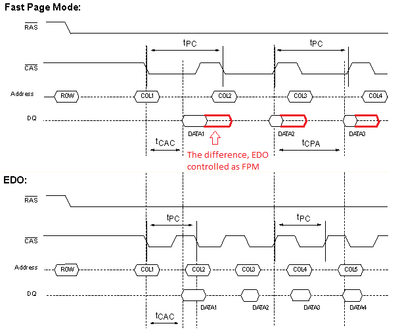

(The sketches are taken from https://www.tu-chemnitz.de/informatik/RA/news … m/section2.html )
If EDO was controlled like FPM, the difference would be the outputs are active longer (red). Question is, would that interfere with something in FPM mode.
The second link I posted earlier says: sometimes yes - sometimes no. Depends on the chipset.
I personally haven't done any broad scope studies by sticking the wrong kind of RAM in all my mobos so I'll take their word for it.
