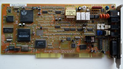

Which card (Crystal/Aztech) exactly do you have? Most ISA sound cards are at least Sound Blaster compatible. You don't always have to use DOS "drivers", since the games support Sound Blaster (and possibly other cards) without an external driver. Some cards need an emulator to be SB compatible, eg. most Gravis Ultrasound models. A card which doesn't need an emulator is preferable.
Lots of great info, thanks. So basically you're saying if I have a Blaster variable in my autoexec.bat, the card might work? I hope that is the case. It's one of those sound cards with a modem built in. It's got a game/midi port on the back. The Crystal chip is a CS4231A-KL and the Aztech chip says AZT2316R. There's also a Rockwell chip (is that for the modem?) and a couple of Yamaha chips that look like the ones to look for on the CT2940! It looks like the one that says OPL on it is a YMF 289B -S. Lastly, there is a Toshiba 70ns memory chip.
Reply 11 of 73, by idspispopd
That card doesn't sound bad. According to gerwin's list (look at his sig) the chips can be found on an Aztech Sound Galaxy Pro16 II or an Aztech Sound Galaxy WaveRider Pro 32-3D. I suppose it is none of these cards because of the Rockwell chip you mentioned, but you could try to use tools and drivers for these cards. The OPL chip is indeed a good sign.
No idea about the modem. Does the card have a modem connector? If not, can you read the exact marking on the Rockwell chip?
The memory chip *might* be a sign that the card can do wavetable. For that to be the case there should be another Aztech chip on the card, though. If it can do wavetable there is a good chance that it can be accessed through an MPU-401 interface.
I'd definitely try to get the card to work. It's possibly better suited for your purposes than a lot of Creative ISA cards.

idspispopd wrote:
That card doesn't sound bad. According to gerwin's list (look at his sig) the chips can be found on an Aztech Sound Galaxy Pro16 […]
I tried the Win3.1 install.exe but it requires an existing Windows installation to proceed. I dug around through the other files in the Aztech_ISA_cards.zip file here and could not find anything that would help me know how to proceed. Nothing at all that refers to DOS that I could find. It's all Win3.1 and higher. I spent most of my time in the P16II and WRP323D sub-directories.
I suppose I can try some variations of SET BLASTER and see what happens?

You generally have to use Win3.1 to unpack the install files. Good news is that you don't have to use the awful Intel PnP tool. I have the DOS drivers for an Aztech 2320 card I can pack up and upload if you like.
Reply 14 of 73, by clueless1

Reply 15 of 73, by clueless1
https://www.youtube.com/watch?v=62IhTnRyLzo
According to the person in this video, the soundcard only plays music in pure DOS. You get effects and music only if you run in MS-DOS mode. I'm not sure how much of an authority he is, but it's the only model-specific info I've been able to find on the soundcard in the C110.

If anyone with a Win3.1 install would be willing to unpack the Aztech 2316R drivers and upload them (or email to me) I'd be very grateful. I'm not sure this sound card will work or be any good, but I'd like try before buying a CT2800. Thanks.
Reply 18 of 73, by gdjacobs
Here ya go. Let me know if you have luck.
One of the lovely features of the Aztech installer is that I haven't found a way of unpacking it without having the card in the machine. Maybe it's doable with non PnP cards.

Reply 19 of 73, by clueless1
gdjacobs-thanks! I'll give it a shot as soon as I can.
All-I've included a photo of the card for anyone curious:
3.85 MiB
1926 views
Packard Bell Multimedia C110 sound/modem card
