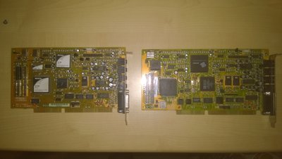

I must be honest. My knowledge of capacitors is very limited but, here goes.

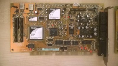

I've taken photo's of the two oldest Aztech cards that I own, namely the Sound Galaxy Basic16 (I38-MMSN810) and the Sound Galaxy Pro16 Extra (I38-MMSN812). The latter is also known as the Reveal SC400 rev.2.

Both sound cards
I've circled in blue the YMF512-M DAC and in red the capacitor that I think you are referring to. It has a rating of 16v, 47µF (which is microfarad and not picofarad (pf)).
All the other small capacitors around the DAC has a rating of 50v, 2.2 µF.

No. If you look at the white silk screen print for component markings, everything starting with a C is a capacitor, not just those big electrolytic capacitors you are referring to. The component in question would be a brownish little surface mount ceramic capacitor, most likely without any markings on it, connected to DAC pin 13.
