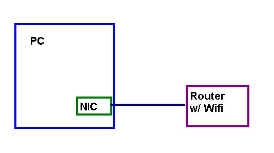

Reply 5 of 98, by PCBONEZ
This way the OS and drivers only matter to a NIC.
10.82 KiB
2566 views

Reply 7 of 98, by PCBONEZ
Sedrosken wrote:
Ahh, client bridge mode. I've done that on a couple routers running DD-WRT, but I've never had anything with stock firmware capable of doing that.
Don't see what firmware has to do with it.
The NIC needs a 9x driver then you set it's IP and protocol.
The router only cares about the IP and protocol and is blind to what the OS is.

Reply 10 of 98, by PCBONEZ
dr_st wrote:
Am I missing something?
I don't think so, unless it's common sense. - The goal is clearly to use WIFI from a Pentium-1 with an open PCI slot running W9x.
The only W9x PCI card suggested so far only supports 802.11b which may or may not be compatible with his/her existing WIFI.
I provided an easy way to achieve the end goal with common parts most 'geeks' I know (or their buddy) would already have on-hand.
He can easily find a router that already works with the existing WIFI. That might not be so easy using W9x PCI cards.
And he could run several retro PCs through the router without futzing with WIFI setup for each PC individually.

Reply 13 of 98, by PCBONEZ
alexanrs wrote:
A bunch of routers I've seen lack the ability to connect to an existing WiFi network, so you can't use one+wired NIC to replace a wireless card. The way to go is to get an old cheap OpenWRT/DD-WRT capable wireless G router, install the custom firmware and be happy. Alternatively I've seen a D-Link WiFi extender (one of those you plug directly into the wall socket) that has an RJ-45 connection and can act as a WiFi client.
It's easy to convert a wireless router to an access point. It's only a matter of settings. (So simple I don't even consider it a conversion, just a configuration.)
No new firmware required.
http://www.practicallynetworked.com/networkin … ccess_point.htm
http://www.tweaktown.com/guides/1575/using_an … oint/index.html
Reply 14 of 98, by alexanrs
Oh no... this is different. These settings are for using a router as an AP - using the new router to create a secondary WiFi network and connect both routers through a wired network, What the OP wants is to connect both routers through WiFi and have the secondary one bridge wired connections into the main network. That is what many routers that do have those settings call "wireless bridge". OpenWRT does not give it special names AFAIR. you just set up a client wireless connection (which is what many routers do not allow) and disable DHCP.

Reply 16 of 98, by PCBONEZ
That's exactly what you can do with what I suggested.
That's how I had my previous residence setup.
Reply 17 of 98, by alexanrs
At least the page you linked me states the following:
When the configuration is done, put the old router in place. Then connect an Ethernet cable between them, plugging into the regular Ethernet ports of each. Do not connect it to the old router's Internet/WAN port.
If he was to run a cable to the secondary router, he might just as well run a cable directly to the machine.

Reply 19 of 98, by dr_st
Once you decide to go wired, your options are basically limitless. Because there is plenty of hardware there (routers, single-device access points, multi-device access points) that can function as a wireless bridge to an existing wireless router.
