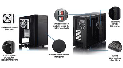

Reply 17 of 22, by Mamba
I forgot to mention that the SSD is mounted behind the motherboard in a Fractal Design Core 3300 (this retro set up is costing me a lot! 🤣 ) maybe they are too close?
The PSU is a Seasonic S12-II Bronze 520
Reply 19 of 22, by Tetrium
alexanrs wrote:
The motherboard tray should be shielding it already....
Anyway, you could try wrapping the SSD in tinfoil xD or maybe part of the SATA cables.
I'd think it's the data cable.
If the data cable is long, he could try and move it around a bit. Or just test it with the SSD removed from the system (on a table next to it and see/hear if it still does that).
