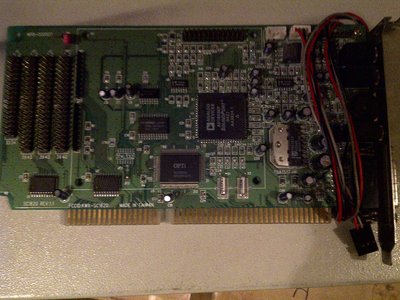

- Formosa (??) SC-1620 rev.1 — I think, it must be a Russian-branded clone of SoundBlaster. Here is how it looks:
2.59 MiB
674 views
So if you had to choose one or two out of this list, what would you pick? I've been thinking about CT4170 and CT4500 (in that order) as they seem to be the most feature-rich.

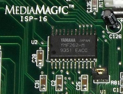

Your MediaMagic ISP-16 should have a real OPL3, if you need a real OPL3 and if the Vibra CT2940 do not have it then this will be the best choice, otherwise go with the AWE64.
I would have chosen the AWE64.
That's an OPTi based card and has a real OPL3. I have a soft spot for these.
I'd probably choose this one for a 486 or older. For a Socket 7 machine, the AWE64 is more useful, as most games of that era supported it natively.

For DOS, I'd pick the Formosa or the ISP16 card (looks like they are OPTi 82C929 based, avoid if its 82C928) - especially if you have a daughterboard - because of good SBPro compatibility, what appears to be true OPL3 (from the little I could see in the picture), software configured (no PnP) and no hanging note bug. I have an OPTi 82C929 card and, for DOS, they are great. For Windows... they kindda suck. The drivers are horrible, with some weird issues in Windows games (e.g. Pandemonium) and relying on being configured on DOS (AUTOEXEC.BAT) or things like the gameport won't work, so they are hopeless for anything newer than Windows 98. You can start them in DOS (in WSS mode) and use the generic WSS drivers that come with Windows, but then you loose its native sound support for DOS games inside Windows, and have to rely on the emulation provided by the generic drivers... also, you lose control over the DBs volume. In the end I relegated the card to my 486 DOS machine, where its weaknesses don't matter.
