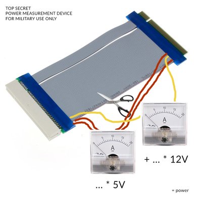

Reply 14 of 19, by adalbert
This is an "artist's impression" of how one could measure power usage ;p

Yes - That's the idea. [Although I don't think the military cares how much power their video cards use.]
A more refined method would be to take the measurements with a data-logging card which could output voltage and amps to EXCEL or something.

Wouldn't it be possible to rig an AGP slot (and perhaps also PCI slot for PCI cards) which keep their data connectors connected to the rest of the board, but have all connectors that supply power to the graphics card be routed via some power measurement device (including molex's etc). This would also give the most natural results.
Another way 'could' be to have the card power on via some rigged AGP/PCI slot which isn't connected to a real computer, but has it's GPU put to work very hard and measure the power usage that way (this solution seems more complicated though, mostly because of drivers?).
edit: I wasn't looking right (I should go to bed), it's basically what you did in your artist concept. But I'd still suggest you create both AGP and PCI ones and also include the molex's and other power connectors 😀
