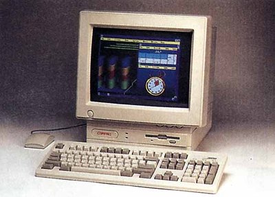

Hi, all
I found a guy who's selling a cheap all-in-one Presario 433, and this machine looks too awesome to ignore!
25.81 KiB
1662 views
I was hoping there were some 425/433 owners here who could tell me about possible quirks.
The machine is stripped of most components (don't have any good photos yet, sorry). It basically only has a motherboard, a ISA riser card and a HDD. I have some SIMM modules and an ISA sound card for it, so it looks like I already have a lot of stuff needed to build it. Here are some questions though, so I could understand if this project is viable for me at all:
1) could it be that this machine had an external PSU?
I looked at the photos here and watched this video (the link has a timestamp where he shows the internals). I don't see a PSU or AT connectors on the motherboard, so I assume that either it has an external power brick, or the PSU is somewhere behind the CRT tube.
But if it's the latter case, is it a standard AT PSU and how does the motherboard get the power? If it uses a power brick, could anyone tell me what its specs are?
2) there is no floppy drive. If I'll get a regular 3,5 inch drive, remove its face panel and insert it, will it fit?
3) some of the reports mention that this machine can't use AT keyboards via a DIN5->PS/2 adapters. Is that true?
4) can I use any 486SX/DX chip (Intel/AMD), or is there any sort of vendor lock-in? I've never built a socket 3 machine before.
Also, does a 486DX2 or lower need either passive or active cooling? Would a Socket 7 cooler fit on it?
Google says that it doesn't, but I wonder if a smaller case would force me to use cooling.
5) would a dedicated ISA videocard be useless with an internal screen? I'm guessing, a GPU wouldn't be able to pass output back through ISA.
Thanks!

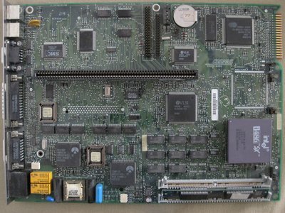

Yep, here it is in the top right corner. Weird that it passes both video and power, though.
Damn, I really hoped it's an external powerbrick 🤣
Edit: I just noticed a small picture of a cyclops near the CPU, it's so cool! I wonder if it's factory made.
Fun fact: In those days, Compaq loved putting little pictures as easter eggs on the motherboards of their systems. 😀 Here's a better view: https://youtu.be/Qt-0lqkJUKE?t=2m54s

Yeah I remember that on the mainboard.😀
I remember was hard to find the correct 72pin simms also cause to test them you have to open it and close it so many times. The speed was nice also cause the onboard vga was a VLB S3 based.

Cirrus Logic 5420 as far as the above motherboad photo shows.
Reply 9 of 23, by BSA Starfire
Cirrus and S3 were pretty much equal at that stage I reckon.
