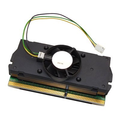

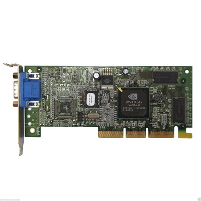

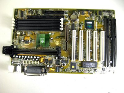

Reply 14 of 19, by gladders
Tetrium wrote:
Give us a pic of the CPU and possibly the board also. Btw, 450MHz will be a Katmai P3, not a Coppermine and it's the Coppermines which have a lot more potential compatibility issues (mostly due to the board not being able to supply a low enough voltage to the CPU). Katmais in a board which don't support them will either display as a Pentium 2 and perhaps in some cases it won't boot. Make sure you clean it's contacts before installing the CPU (with either rubbing alcohol or a pencil eraser are easy, cheap and effective) and be sure you pushed the CPU cartridge in all the way.
Motherboard attached...
    231.79 KiB
    857 views
    Soyo SY-6BA
Reply 17 of 19, by Tetrium
Gladders...are those pics of your hardware? And I mean your components you pictures with your own camera? Or did you simply download them from somewhere?
Anyway, the pics look nice, but the name of the pics have weird names which resemble the ones I downloaded from certain second-hand seller sites.
Anyway, your graphics card's GPU is a Vanta-16, which is iirc the slowest of these budget cards. It's bracket looks like one of those low profile ones.
The CPU pic doesn't show any of it's markings, it's only good for showing it's a Slot 1 CPU but we already knew that 😜

Reply 18 of 19, by gladders
I got the items off eBay - these are the pictures that represented them on their page. I don't have my own photos and I can't dig out the components to take photos.
Ah, phooey 🙁 Oh well, it was only a fiver. I'll shop around for a better card. Someone mentioned a GeForce4 MX 460 - they don't seem outlandishly expensive.
Aw ok. I'll see if I can dig out the processor tomorrow and take a snap.
