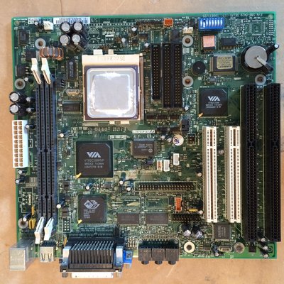

I have this eMachines Delhi-III Socket 7 motherboard from the late 90's.
I cannot find ANY documentation whatsoever on the Internet for it, but
I need to know how to configure the bus speed and cpu speed so I can use
it with my Pentium/100. It works fine with an AMD K6-II and a Cyrix 686, but
not the Pentium, so I assume I have to use those DIP switches and/or various
jumpers to configure the speed, multiplier, and voltage. Have any ideas? Thanks!

Here is the manual.
Delhi_3.pdf
335.53 KiB
23 downloads
It was the first hit on Google.
I searched for: delhi-III socket 7 motherboard.

It seems to be a nice little motherboard with support for most Socket-7 CPUs.
Reply 4 of 5, by keenmaster486
Tried it out using the instructions - now it works perfectly. Thanks again! Do you know if I can flash the BIOS on this thing to something more normal? Right now it has the old eMachines bios which hardly lets you do anything. I think it's an award bios.
