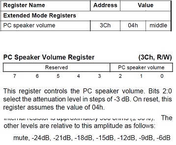

Does anyone know about dedicated mixer software working under MS-DOS for ES1946s Solo-1 sound card? I have that card in my Presario 1800 notebook, and the issue is that PC-speaker beep is so loud that my ears are bleeding (that laptop has big and loud JBL speakers).
Of course it has built in buttons for volume control, but it looks like that PC-speaker beeps are going through different output (Solo-1 has dedicated pin for PC-speaker) and are hardwired to the speakers. I can lower the volume to acceptable level by using Windows 98 volume mixer, it is possible to set PC-speaker volume, but I alsoo boot into MS-DOS and Win 3.1 and there I have no control over PC-speaker. I can modify the volume with volume buttons or utilities like SBPVOL.com, but there is no option to set PC-speaker volume.
I looked into the datasheet and there are listed registers responsible for setting the PC speaker volume.
I have no knowledge about programming in assembly language, but I guess that it should be possible to lower that beep volume by writing a small program just setting one register in memory. So, the best option would be to find appropriate mixer software, but if nobody has it, does anyone know should such simple assembly script look like, or how should i use MS-DOS debug.exe in order to check the value of such register and modify it?

Say your soundblaster port is 220h.
- write 3Ch to 224h.
- write 00(loudest)-07h to 225h.
in debug:
o224 3c
o225 07
Worth a try 😀
But I'm afraid whenever a game resets the mixer this change is gone.

Great , it works! 😁
And actually 00 is mute and 01 is most quiet (not so quiet, but A LOT better), 07 is normal (max). That setting seems to be active after restarting a game, and even after rebooting the laptop! So I will just put that into autoexec and it will solve the problem.
