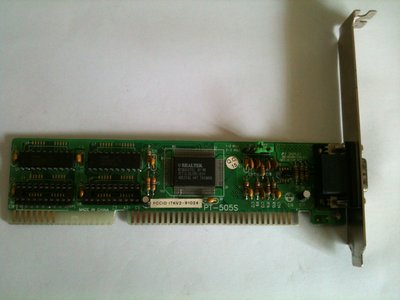

I think the slowest ISA VGA card with 512K is the Realtek RTG3105iEH, it managed to drag my a socket 7 Winchip 200Mhz system down to 486DX/2 66Mhz levels in Phil's benchmark suite.
1016.04 KiB
841 views
This one does only have 256K but I doubt the extra would make a difference for speed. This must be the simplest and one of the very last ISA VGA cards.

yeah i knew about this infamous realtek3105 thing. from some benchmark reports its indeed even slower than the trident ones, and from the model "PT" on the card it seems to be made by xfx.
the rtg3105 is a low cost solution with integrated ramdac and supports only up to 512k ram just like the trident9000, but i dunno if its internal ramdac supports 16bit mode, which the tvga9000 does.
