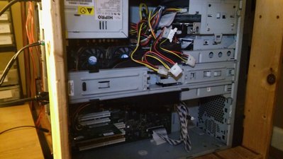

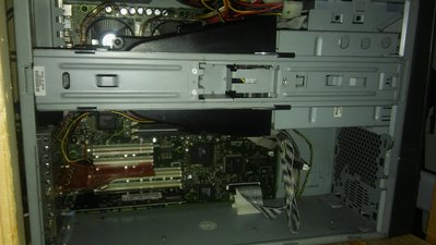

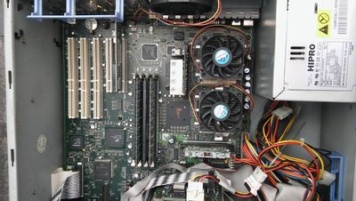

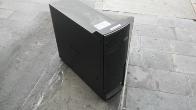

I recently got an old IBM xSeries 220 for 4 € from a guy who has several stuff for scrap, i wanted to try old server hardware and found the IBM and probably some other servers as well.
When i looked closely, it turned out the server has two Tualatin based Pentium III-S 1.40 GHz with the S-Spec SL6BY and 3 GB PC133R ECC, but had some issues/limitations:
1- One of the VRMs were faulty and the Second CPU is not enabled (i tried swaping the 2 VRMs between the 2 sockets and only worked the socket with the good VRM)
2- The server came without SCSI HDDs, only an IDE HDD on the 5.25 bay on a ATA-33 Controller
3- Lack of AGP slots for graphics cards (i already expected that though)
4- Only supports registried RAM, PC133R ECC to be exact
5- The third RAM stick were damaged, so i had to lower the RAM to 2 GB which is still plenity for a Pentium III
6- CPU-Z hangs the OS when i try running it (at the detection complete stage, is the only program that hangs the PC though)
I plan to do the follwoing changes/upgrades:
1- Buy the SCSI caddies and some 36-73 GB SCSI HDDs and dtich the IDE HDD(i already found it on ebay) - done
2- Get a new VRM for the second CPU - done
3- Get a PCI videocard (Geforce 2 MX or better) for the server
4- Add a soundcard (done, used an old Creative Sounblaster PCI128 CT5880)
5- Reacoditionation and cleanup of the case
6- Swap CD with DVD Drive

    Inside of the server

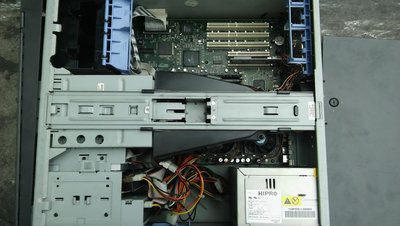

    Opened

    Server

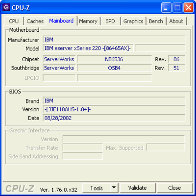

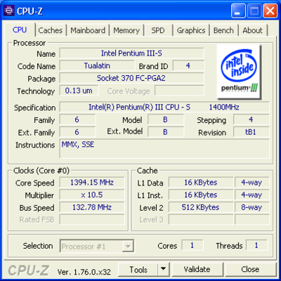

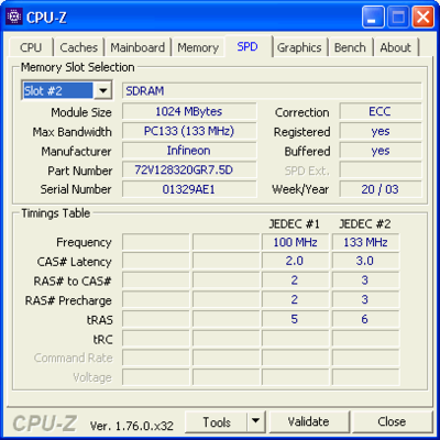

Reply 4 of 11, by Carlos S. M.

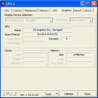

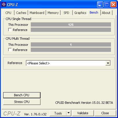

CPU-Z screenshots (1 CPU). There are some missing data since the sensor setting is disabled (enabled makes the whole system frezze)

    CPU-Z Graphics

    CPU-Z Bench

Reply 9 of 11, by Carlos S. M.
Update:
The SCSI HDD and the VRM came. I installed both and installed the OS on the new HDD, older IDE HDD was removed
CPU 2 is now recorgnized and enabled.

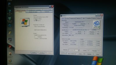

Update (24th June 2016):
Added PCI USB 2.0 Card (NEC based).
Replaced Windows XP with Windows Server 2003 Enterprise.
The still is still going strong and the next part i might get will be a PCI videocard
    1.25 MiB
    896 views
    System propieties and CPU-Z
