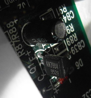

Reply 2 of 16, by arteq
you have saved my day 😀
but one more request , my mobo also miss this transistor , could you please take a photo of it ? 😀
thx

Reply 3 of 16, by kixs
Another one:
    139.82 KiB
    670 views

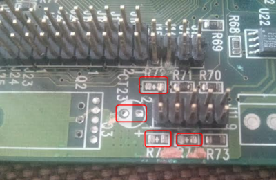

but one more request , also this diode and capacitor is missing , do you mind to take a photo ?? 😀

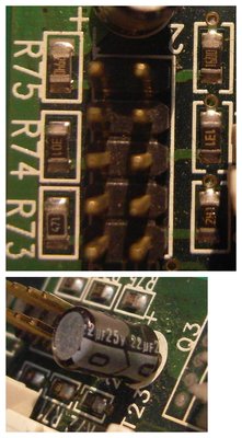

Reply 8 of 16, by kixs
arteq wrote:
sure I will […]
sure I will
ps
what bios version do you have ? maybe problem with 3.45v is connect with bios problem ?
Diode looks the same as D5. I can't get a clear photo - lightning/focus problem.
Capacitor is the same as pictured before (CT23) - 22uF 25v.
Not sure what is the problem with voltage regulator. If I set jumpers to anything but 5V the board won't post. It works fine on 5V.
EDIT:
Adding photos...
    312.77 KiB
    598 views
