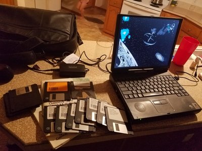

My grandpa brought by my Great Uncles Gateway Solo 2500 Laptop running Windows 98. Has all the original driver disks so far as I can tell. Just missing the Windows CD and License for some reason.
P2 266
64MB of RAM
NeoMagic Magicgraph 128XD
NeoMagic Magicwave 3dX Sound
6GB hard drive
CD-ROM Drive
LS-120 Super Drive
PCMCIA 33.6 Modem
Anyone have much experience with the NeoMagic video and sound? From a Video perspective I imagine it's probably fine for any DOS game but 3D Accelerated games will probably suck. Is there any way to attach a gameport to this thing that will work in DOS?
Battery is dead and battery door is missing but it locks in place in spite of that.
Any other thoughts on interesting things to do with this system?

Reply 1 of 16, by Aideka
I have no idea about the sound, but the video may be a bit quirky even on dos, some resolutions in both Dos and Windows just don't work right. I remember having issues with stuff that used Direct Draw on windows for example.

Reply 5 of 16, by Aideka
It was the video adapter, some programs like the Nesticle NES emulator that I tried refused to show any kind of picture on certain resolutions and others looked, well, messed beyond belief. The dos version of Nesticle worked on some resolutions the Windows one didn't tho. I could try some games on my laptop if you need me to test something? The video adapter on my laptop is Neomagic MagicGraph 128ZV tho, so maybe yours works better.

Reply 11 of 16, by stamasd
The NeoMagic video chipsets suck. I have one (NeoMagic MagicGraph 256AV) in a Thinkpad 570, it is absolutely horrible under Windows. It's OK in pure DOS though for VGA games. Just don't expect any acceleration for 3D games.

NeoMagic not suck at 100% I have NeoMagic MagicGraph 256AV+ in my Sony Vaio PCG-F707 laptop with Pentium III 600 and I even can watch there DVD`s, mp4, play some 2D games like Diablo II, Baldurs Gate or even Icewind dale without any problems and from other side lack of 3D acceleration is huge pain there. I don`t know why someone put for PIII 600 such videocard there, in my opinion that videocard is suitable for Pentium 133/166 MMX.
Because it was cheap. My Thinkpad 570 pairs it with a PII-366. It struggles pretty badly with 1998-ish DirectX5 games such as Hardwar.

On my laptop even Half-Life in software in 1024x768 is almost smooth, I can also play UT or Quake II in software and are smooth in 640x480, 2D games run very good and smooth, only Red Alert 2 slowed down very much and was unplayable when I tried it. But now I play only Diablo 2 without expansion in 1.00 version and run very good, and I have 256 MB of ram.
