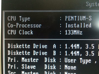

I want to put my 80502133 in my Socket 5 machine. Theoretically this should be possible since I can set the clock at 66 MHz and the multiplier at 2. But will it work? I keep reading that Socket 5 only supports up to 120 MHz but the jumper settings are there. What if I take my 133 and underclock it to 120?

Socket 5 always supported 133Mhz CPUs. I owned a Packard Bell that came with one. Socket 7 was needed for the higher clocked split voltage MMX CPUs.

The pentium 133 was a socket 7 cpu and if i remember right these had an extra pin so they would not fit in socket 5. However pentium mmx would, no dual voltage support tough so they would run overvolted.

Intel Pentium 133 - A80502133 / A80502-133, Sockets:
Socket 5
Socket 7
www.cpu-world.com/CPUs/Pentium/Intel-Pe ... -133).html

It works!
732.8 KiB
1272 views
YES! Instant bump in framerates, now Descent 2 is quite playable at 640x480. Nice.
