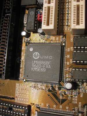

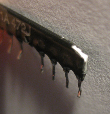

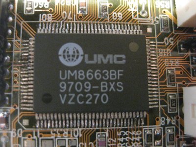

Reply 8 of 90, by feipoa
I finished probing the board with my multimeter. I checked all resistors, inductors, diodes, and most resistor packs. I checked a few SMD capacitors. The only glaring item was this resistor pack with a chip on the corner. This chip changed the resistance for the 10th pin only. Instead of 4.7 K-ohms, it measured 8.22 K-ohms. I merely replaced the resistor pack such that all pins are 4.7 K-ohms. This did not solve the problem.
58.03 KiB
4903 views
I am attaching photos of my SuperI/O soldering job. The pins which look questionable, I confirmed that they are hitting the trace by ensuring connectivity with the other end of the trace.
168.63 KiB
4903 views

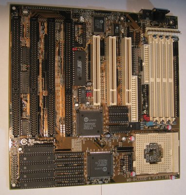

I'm also attaching a high-resolution photo of the current state of the motherboard. Maybe someone sees something I am missing. The RTC was removed for the photo only. All the electrolytic caps have been replaced as shown. For the 100 uF caps, I used aluminum polymer caps due to the low profile, the others are electrolytic. Also shown is how all the DIP IC's are socketed.
2.38 MiB
4903 views
Pending any other ideas, I will need to replace the southbridge chipset, which has a lot tighter spacing compared to the SuperI/O. I am doubtful that I can pull it off, especially due to the close proximity to the ISA, PCI, and DIP slots. I have soldered about 10 pins of a chipset with tight spacing like this in the past. It was a nightmare, but eventually worked out.

I'll be stuffed if I can find any datasheets for these chipset and IO ic's anywhere. I wonder if the 2 You have replaced have got a clock signal? 5v?
These motherboards are multi-layered so there could be a blown track between the top and bottom layer and You'll never see it.
I would forget about replacing that large IC, too difficult. The one You have replaced might look a bit better if You used flux paste, it's
impossible to recreate that factory solder job by hand wihout it.
