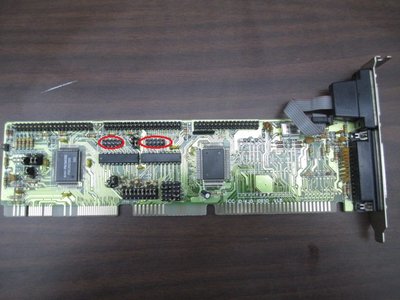

Would this work? I have the KJD-IDE10 which has CN4 and CN5 10 pin serial connectors on the card. See here:
http://stason.org/TULARC/pc/hard-disk-floppy- … SIO-V2-313.html
109.3 KiB
1238 views
I have the DB24 connector from the Promise DC-420 with the 10-pin connector on the end. Would I be able to connect this and then use one of these to convert it to a 9 pin female DB9 for a serial mouse? See here:
78.85 KiB
1238 views
Here is the adapter:
http://www.trianglecables.com/product/DB9-Fem … CFYJpfgodg8MNxg

Reply 35 of 45, by TheMobRules
In that case, since the KJD has serial port connectors you can just plug the bracket you have to CN4 and set that connector to COM1.
You can use an adapter for DB9, but you would need a DB9 MALE to DB25 female. Or you could just get a DB9 bracket and plug that to your card.
Keep in mind that there are 2 different conventions for serial connector wiring, so if it doesn't work straight away you may need to use the other one:
http://www.bodenzord.com/archives/117

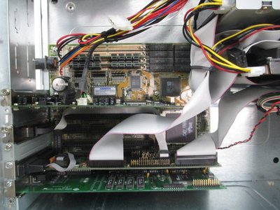

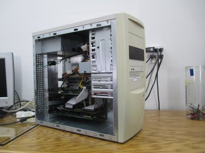

Reply 37 of 45, by rick12373
So with the new I/O card card in there everything worked first time! Hard drive, floppy and CD-ROM all functioning. I also found a better ATX case that actually had the standoffs for ATX and AT motherboards. It may look like crap but it looks like everything is working now. I will not be able to test the serial mouse in the DB25 until the adapter arrives though. I attached the power switch on the back.

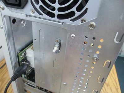

Reply 39 of 45, by rick12373
So I got my serial port adapter plugged in to the 10 pin serial port which is connected to the internal 10 pin serial port of my connector of KJD-IDE10 I/O card using the cable pictured earlier in this thread. When I boot, CuteMouse reports that it is installed at COM1 (03F8h/IRQ4) in mouse systems mode. When I try to test the mouse by running edit.exe I am unable to move the cursor around with mouse. Do I need to tell CuteMouse to use a different COM port? If so which one and how would I edit my startup files?
