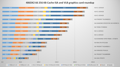

So I'm back to working with 486 gear and MS-DOS 😀
I wanted to test all my ISA and VLB graphics cards on a 486DX2 66 and see how they all compare.
System specifications:
Biostar MB-1433/50UCV-D PCB VER: 2
8 MB 70 ns memory
256 KB 20 ns Cache
Intel 486DX2 66
BIOS defaults loaded
ISA IO controller
The 486 is an average system I would say. I tried faster Cache and memory timings but the system wasn't stable. Left it at BIOS defaults. The ISA bus speed is set to CPU Clock / 4 which gives 8.33... MHz.
Some graphics cards only have 256 KB of memory, so no results for SVGA. Other cards needed UNIVBE loaded, but even then some glitched out. Easy to see in the missing colours for those results! UNIVBE wouldn't work for the ET4000 to get PCP Bench SVGA going, but
Benchmarks run are:
- 3DBench 1.0
- 3DBbench 1.0c
- Chris' 3D Bench
- Chris' 3D Bench2 SVGA
- PCP Bench VGA
- PCP Bench SVGA
- Wolfenstein 3D
- Doom
- Quake
My thoughts:
- I don't have any higher end VLB cards, the CL cards are the best I got
- Looking on eBay, CL VLB cards are easy to find and not too pricey
- ET4000 or S3 VLB cards seem hard to find and / or expensive
- WD ISA card is the fastest by the tiniest of margins. It also doesn't need UNIVBE, the ET4000 does
- ET4000 also very fast
- ISA CL good performance
- Avoid very old looking cards and Trident / OAK cards
- OAK ISA card: The decelerator. Maybe useful for slowing down fast machines?

Interesting that the GD5429 is consistently faster than the GD5428, but the GD5424 is consistently slower than the GD5422. I would be surprised if VLB ET4000s or S3s could top the 5429. So guys: if you're building a 486 VLB system, save your money and buy up the CL cards that desperately need loving homes! 🤣.
That P9000 is pretty bad. I seem to remember it getting high marks in Windows benchmarks back in the day. But its DOS performance is kind of crappy.

I'm running a VLB S3 805 and would love to see where it falls in with your benchmarks. I have done some of my own that were slightly faster than you have the GD-5429 at, but of course it means nothing as the board/memory etc. could have an effect too. (10.6 PCP Bench VGA and 27fps in Doom)

really like these old school benchmarks, on my 486/100 setup I use a WD90C33 VLB vga - a CL5428 is a little slower. I like both equally but they are just generic cards, nothing special...

Cool stuff, thanks for this. Recently I benched the S3 805 against a VLB CL-GD5430 and the S3 is significantly faster at Doom and 3DBENCH2, so it would be cool to see some faster cards thrown into the mix as well. (What retro activity did you get up to today?)

my benchmarks from my Intel 66mhz dx2 and a VLB ET4000 are very comparable with your CL-GD5429.
3D Bench - 42.2
PCP Bench - 9.5
DOOM - 25.2
Quake 5.8
But I'm using a different motherboard with a different chipset and memory settings so its a pretty invalid comparison I suppose.

I performed similar tests on a DX4 and got slightly diferent results. In my tests the Paradise cards (WDC) got a 5% lead in PCP bench and 10% in doom over the ET4000AX. Also, not all ET4000AX cards are created equal. Some are faster then others. It depends greatly on chip revisions and memory. Later cards are up to 10% faster then early models. Late CL isa cards are on par with the ET4000 in DOS, but a lot faster in windows. Lastly, your Trident 9000i benches are quite a bit off from mine. My card scored a bit faster then the CL5424 in your tests - but there's great performance difference between Trident 9000 cards. Some have crappy slow ram and a minimalist design - stay away from these. My fastest 9000i (only one I kept) is up to 30% faster then other similar cards with the same chipset. The only physical difference I spotted is that the faster card uses a different revision chip and EDO vram.
It's also unfair to stigmatize trident cards - some cards are actually very fast. Most VLB cards perform great in DOS and windows, and late model ISA cards equipped with EDO vram are worth looking into. Besides, a WDC or ET4000 card isn't really gonna speed up your 386 much - a much cheaper 9000/9400 should perform the same. I'll run some benches on my 386 to back up my claims. Do keep an eye out for mid 90's PCI trident cards - they're great for dos. Not as fast as a trio3d, but just as compatible. PCI trident, cirrus logic, WDC paradise (ARK) and S3 cards are the most compatible things out there for DOS games. Paradise PCI cards (Bali 32 and Barbados 64) are quite rare and pretty fast. Some have WDC chips, others ARK Logic. There's even a VLB version of the ISA WD90C33 - and boy - VLB it's where it shows it's muscles.

It does show that the S3 and ET4000 VLB are a bit faster, not by much, but faster, so that is very good to know 😁
