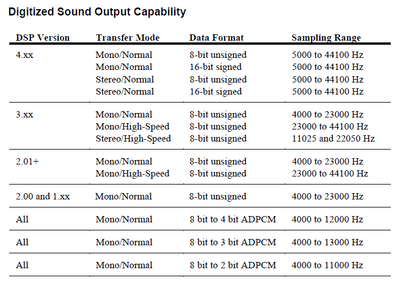

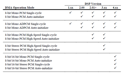

Reply 13 of 47, by James-F
NJRoadfan wrote:
I think the whole point of the Soundblaster 16 option in setup programs was to get back the stereo audio that SB Pro only games lost since Creative cheaped out on backwards compatibility with the card.
If I would have to guess I would say that Creative completely removed High-Speed mode from DSP version 4.xx because the technology allowed Normal mode up to 44.1kHz.
I assume that Creative had reasons behind that decision because High-Speed mode must have been limited in some way.
But why didn't they think about the games that already use the high-speed mode is a mystery.
The SBPro 1.0 was introduced in May 1991 and the SB16 in June 1992, but the SBPro 2.0 was also introduced in 1992 and continued selling along with the SB16 well into the 90s.
So this is indeed a mystery why the SB16 don't support high-speed modes, SB2, SBPro1 and SBPro2 did.

ZanQuance wrote:

Reply 14 of 47, by gdjacobs
Are there many titles that use those modes?

Reply 18 of 47, by James-F
Usually when SBPro high-speed DMA Stereo is supported the SB16 is also supported.
