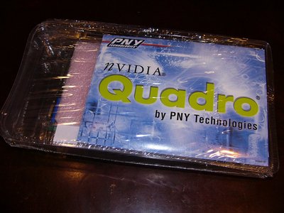

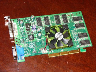

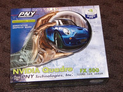

I already have too many Geforce 2/3/4-class AGP cards, but I couldn't resist these NIB Quadro FX 500 cards on eBay for cheap. The Quadro FX 500 is a low-end Quadro with an NV34 core (the same one from the Geforce FX 5200 / 5200 Ultra).
Did a quick comparison with my GF4 Ti4600 using Unreal Gold. 1024x768 (56.64 drivers). Using an SE440BX-2 with a P3-1000. (I also added the UseVsync=True to the D3D section in unreal.ini to turn off Vsync--it's backward).
GF4 Ti4600: 74.1 FPS
Quadro FX 500: 72.4 FPS
I was surprised by how well the Quadro FX 500 kept up with the classic GF4 Ti4600. I didn't have time to run 3DMark or any OpenGL benchmarks.
What I don't know is what kind of compatibility issues crop up using the NV34 core vs the Ti4600's NV25 core.
Overall, this might be a DX9 card that is an inexpensive alternative to higher-end DX8 GF 4 cards. More testing to follow before any conclusions.

It does seem to be a very good card. I got some of these in a bulk lot about 1-2 years ago but haven't done much with them. I made sure they worked but I never took the time to compare them with other cards, so your test info is interesting. Looks like the FX500 would be close to a Ti4200 in DX8.
In the little testing I did it seemed that they have very good image quality and they also have top notch capacitors on them. Such are the perks of a Quadro card. The fans might be more reliable as well, but I don't know that for certain. 128-bit memory, no fear of ending up with a nerfed 64-bit card. I think the specs on this card are most closely equivalent to a 128-bit FX5500.
