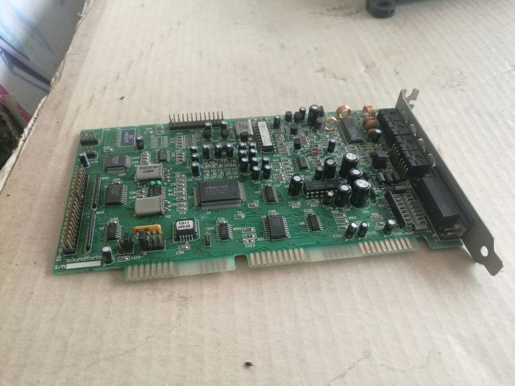

OR.... Vibra 16S
Which one should I go for? 😕

Yeah, I just upload it from my phone. Sorry for the poor quality. My phone camera is crappy... ..
Oh.. YXG is not related to the soundcard.... okay...
I was thinking maybe it will perform... better? 😐 I guess not...
so which one should I choose?
Base on the picture, both have IDE and Wavetable pin on top. .(if im not mistaken)...
Anybody have experience on these cards?

Reply 5 of 19, by noshutdown
my vote goes to the vibra, for its a special card made by soundforte using creative chip, rather than creative's own product.

Reply 19 of 19, by gerwin
James-F wrote:
That is why when you buy a sound card for DOS make sure it has an original OPL3 chip.
The Yamaha YMF701 or 71x has the original (obviously) OPL3 chip already integrated into the main chip, your Vibra 16S has the Creative clone (not all of them).
On the photo of the Soundforte Vibra16S: the marking of this leftmost chip cannot be read, but I still suspect that one to be the OPL3 clone. It does not look like a creative CQM chip, it is probably some obscure clone, that may actually sound 100% like an OPL3... or not.
