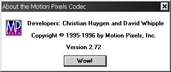

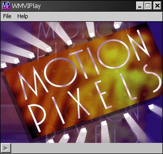

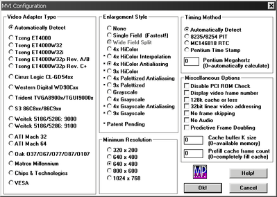

Reply 57 of 86, by lolo799
Does anyone remember the Motion Pixels codec and player from 1996?
Its minimum system requirements were 486 DX 66Mhz/8 MB RAM/128K Cache/1 MB VESA Local Bus Video card/4x CD-ROM/SB card or compatible/DOS 5.0/Win3.1
The recommended specs: Pentium 75 MHz/16 MB RAM/256K Cache/1 MB PCI Video card/DOS 6.0/Win3.1, 3.11 or 95

The last version of the player even supports the 3dfx chipset:
MP Objects™: 3Dfx Support by Christian Huygen Ok gamer fans, Motion Pixels now supports the 3Dfx chipset. Using the Bilinear t […]
by Christian Huygen
Ok gamer fans, Motion Pixels now supports the 3Dfx chipset. Using the Bilinear textured filtering on your 3Dfx card you can have very quick 640x480 16-bit interpolated video. It looks killer! David and I have been watching this upcoming and rising 3D standard for the gaming market and have now taken advantage of it.
Motion Pixels does require that the GLIDE2X.DLL driver version 2.43 to have been previously installed on your system to get it to work. If it's not there and we detect a 3Dfx chip Motion Pixels will let you know. If your 3Dfx card manufacture does not already have it installed then you can download it at:
http://www.3dfx.com/software/download_glidert.html
All you need to download is the Glide 2.43 runtime drivers. Please install it and you will be ready to go! If for some reason the Motion Pixels cannot see the 3Dfx card please type in 'chdwtestpci' on your keyboard without any menus pulled down from the AWARE32.EXE player and make sure that the VendorID=121A and the DeviceID=0001. When you first start the fullscreen playback using the 3Dfx option located in the playback style dialog under the fullscreen section, you will notice that the first time you play the video you will get the 3Dfx splash logo. If you would like to disable the logo from ever appearing (I personally think its cool, and it also lets you know that you are playing on the 3Dfx card) you can add the following line to your AUTOEXEC.BAT file and restart you computer:
SET FX_GLIDE_NO_SPLASH=1
If you always want to know that you are playing fullscreen video on the 3Dfx card, or just want to show off to your friends that you are playing fullscreen video on your 3Dfx card then you can add the following to your MVICODEC.INI located in your windows subdirectory:
[MVI1] Enable3DfxShamelessPlug=1
If you want to really see the difference that bilinear textured filtering makes on the 3Dfx card you can disable it so that it just looks like 4x pixel enlargement by adding the following to your MVICODEC.INI located in your windows subdirectory:
[MVI1] Disable3DfxBilinearFilter=1
Gamers get ready for fullscreen in your face 3Dfx video!

Here are the players I found, the 2.7x from an old Magazine CD and the 5.02 from the archive of the official website:
Mpixels2.rar
3.86 MiB
48 downloads
Versions 2.71 and 2.72, includes the DOS player
Motionpixels 5 installers.rar
2.91 MiB
46 downloads
Version 5.02, 3dfx compatible, installers for Win 3.x/95/NT

Reply 58 of 86, by emosun
Now that looks pretty cool. I do have a voodoo2 but id like to see how well it does on its own at first. It does mention the video will only be 16bit so that may explain the higher resolutions
