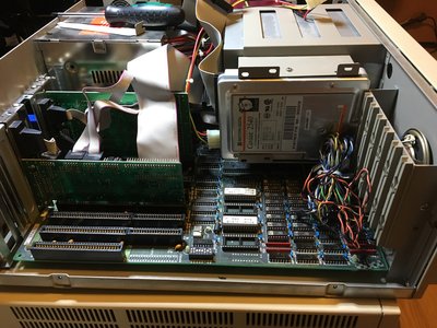

finally I managed to come across a nice AT case which will take my huge 286 board.
The board seems to work fine, has 512kb memory onboard and a ceramic intel 286-10 socketed.
my trident card is recognized and works (it has 512kb memory, just like the motherboard 🤣 ).

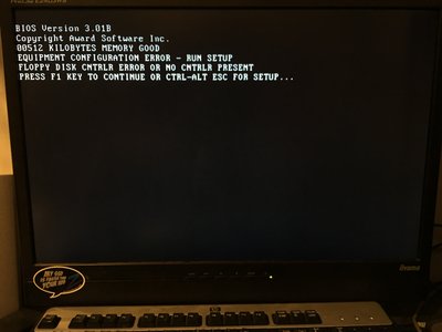

BUT the I/O card doesn't seem to work. all i get is what you see on the screenshot.
i've tried a goldstar and a umc i/o card, neither of them worked. can't rule out that they're both defective, though. didn't test them in a known good system yet.
any idea what could be the issue? unfortunately i've got no manual for that board. i bought it from amoretro
on ebay, who usually has working, very good hardware. so i dont think that the motherboard itself could be the culprit..

It doesn't answer your question, but I noticed that hard drive looks too large for that board. If I remember right early motherboards (up until '93 or '94) could only support up to 520 MB thanks to Bios restrictions. Yours is 540 MB. You'll need to partition it before it will register. You might be better off with a Caviar 2420 at 420 MB than a 2540.

Is there a jumper on the IO boards to disabled the Floppy controller? I have a couple of winbond multi i/o's that were all set by the previous owner to disable floppy, presumably because the motherboard had a controller built onboard.

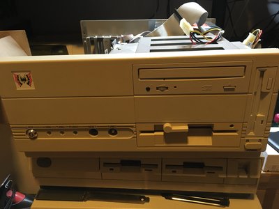

Do I spy an IBM PS/2 Model 30 8086 under that 286?
indeed, you do 😉
edit: look at our post counters and join dates 🤣
Now we're even. 😁
On a serious note, I have both 8086 and 80286 Models 30s. My 8086 came with a dead 20MB drive (no surprise), and missing floppy bezel. The 286 is complete, but it's the single 1.44MB variant (8530-E01). I have some SCSI cards and an old (Mac) NuDesign external 340MB drive that I think will work with it in place of those horrible ESDI drives.
Anyways, sorry to derail the thread. 😁

i tried another IO card for which I had a sheet describing the jumper settings and voila, the floppy drive lights up and does something. I had to choose "special adapter" for the video card to get rid of the equipment configuration error message.
the floppy drive is spinning now, but it doesn't seem to read the disks properly. all i get is a boot error, like if there was no floppy disk inserted. is there anything else to be aware of? it could also be the drive itself, i didnt test anotherone yet, cause i'll have to get one from the basement first...
