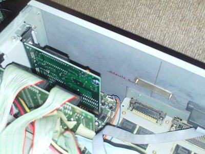

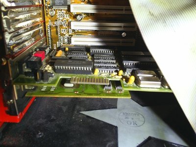

Okay, so I tried again. This time, I removed The Trio64 and installed an ET3000.
I did this, because I was afraid VGA might be an issue. "So why don't you use your XT instead ?", you may ask.
Well, that's a good question. The answer is, I'm afraid to break it in the process. 🙁
95.55 KiB
2764 views
So I ran DMODE and changed to CGA mode to hopefully match my one and only XT machine..
109.76 KiB
2764 views

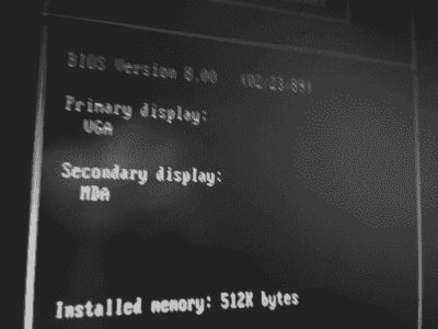

Changeing the video mode worked fine, even both cards were detected:
78.09 KiB
2764 views

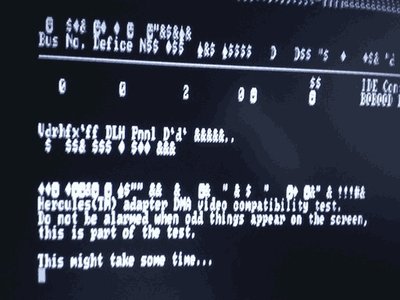

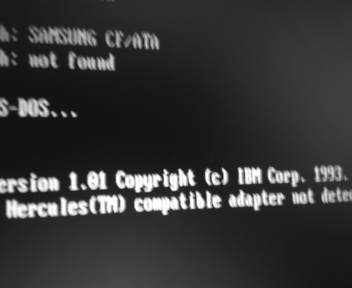

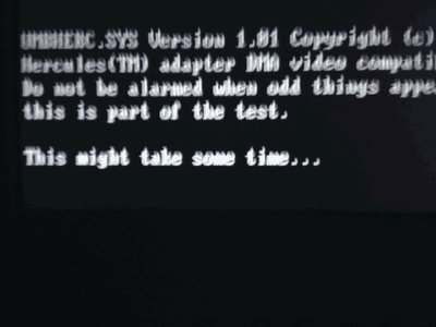

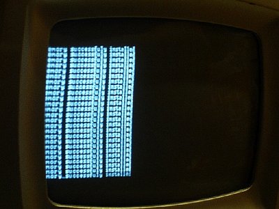

However, after booting I got this error message:
74.19 KiB
2764 views
Hercules(R) adapter DMA video compatibility test.
Do not be alarmed when odd things appear on the screen,
this is part of the test.
This might take some time...
Yeah, the screen was odd for sure! But I doubt that this was actually part of the test..
And how long does this really take ? Did I just not wait long enough ?
So I tried again and removed the HGC card completely (while the ET3 was put in MDA mode).
Unfortunatelly, this changed very little except that the glichty text was gone:
49.12 KiB
2764 views

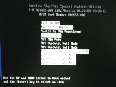

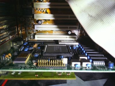

Another day, another try.. I combined the Hercules clone with an 8Bit Paradise VGA card.
The Paradise VGA Plus Special Feature Utility (what a name!) was apparently smart enough to detect the Hercules card.
91.44 KiB
2740 views
Because the selection for VGA Monochrome and Hercules Half-Mode and Full-Mode weren't selectable.
CGA was available and mode switching worked fine.
66.18 KiB
2740 views

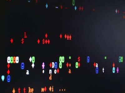

My hopes rised and I watched the slow memory count after reboot.
I was entering the CMOS setup again, to check again if everything was fine.
After I left it, the PC rebooted again and I was hoping for the best..
46.14 KiB
2740 views
Unfortunatelly, I didn't work. And I was greeted with colourful smileys instead. Laughing smileys..
I know, this because of technical reasons but it really feels like that PC is making fun of me. 🙁

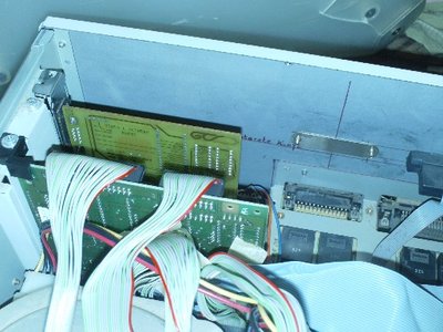

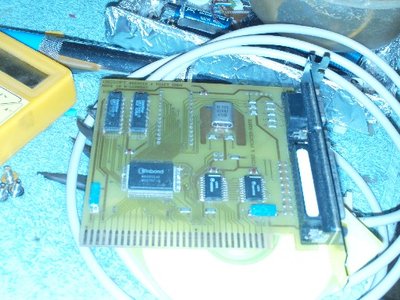

Okay, tried a different Hercules card, a TD8088A.

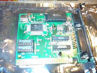

This one seems to have an additional character ROM, an UM23C01.
217.51 KiB
2619 views

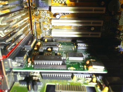

I installed it side-by-side with my old ET-3000 :
198.08 KiB
2619 views
Unfortunatelly, it didn't work this time either. 🙁

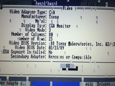

When I by-passed the DMA test with the /X parameter, I got an error about bad memory and also a strange result from MSD :
It detects a CGA card made by Tseng, including a video BIOS. Nothing wrong here, but a CGA card normally doesn't have a BIOS.
I wonder why it still detects the VGA BIOS even though the card was put in CGA emulation mode.
Could it be that umbherc.sys doesn't work with CGA emulation ? Do I also require a genuine CGA card, as well ?
177.88 KiB
2619 views

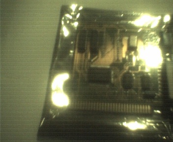

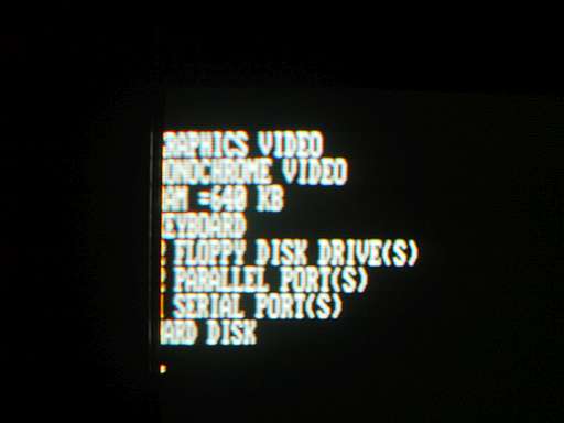

Edit: I tried it tonight, as promissed! 😀 - I installed a HGC card with Winbond chip and it got detected by the BIOS.
Then DOS booted and umb.sys found some memory ("memory successfully installed"). After that, the machine hang.
My PC is an Nixdorf 8810 M35, powered by a NEC D8088D and on-board CGA (an oddball version ?, I've got no docs about it).
Maybe I need a NEC V20 for umb.sys ? I also changed the parameter to B0000-B8000 and inbetween (B2000-B7000, etc.)

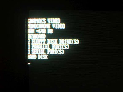

    53.98 KiB
    2408 views

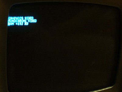

    BIOS reports "GAPHICS VIDEO", "MONOCHROME VIDEO", "RAM = 192 KB"
    (still counting)
    85.53 KiB
    2408 views
    My HGC clone w/ Winbond chip.
    74.85 KiB
    2408 views
    Card installed.

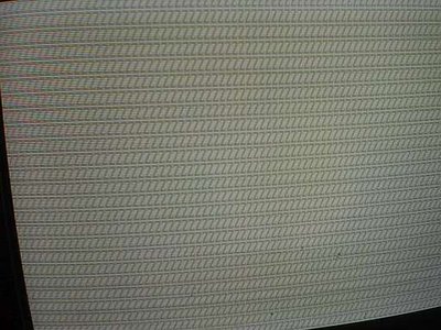

I installed this Hercules clone card in the M35 computer and added umbherc.sys to config.sys (device=umbherc.sys /x).
I also added the /X switch to skip the DMA test, since it never completed in earlier tests.
Strangely, the driver loaded but I got a white pattern. Overlapping memory, maybe ?
Anyway, DOS completed booting and I could enter DIR (the big old HDD started to work).
Entering MODE CO80 had no effect.
26.37 KiB

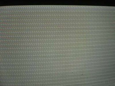

34.1 KiB
2248 views
UMBHERC.SYS loads, but weird patterns appear.

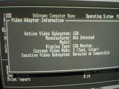

Microsoft Diagnostics (MSD) detects both video adapters.
Hercules is secondary.
33.05 KiB
2248 views

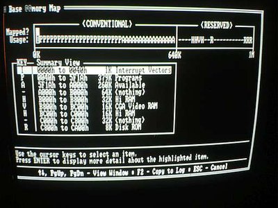

Checkit shows the memory map.
I see no conflicts, just lots of free space. Anything unusual ?

Reply 18 of 30, by BitWrangler
I can't see how you either disabled all RAM above 640k or only installed 640k in the 586 so there was no conflict with existing memory.
Edit: I'm also thinking XT side, that back in the day I never managed to get an expanded memory card working in a machine that didn't have a full 640.
Reply 19 of 30, by Jo22
Thanks to all of you! 😀
Is there anything left I can try to make it work ?
Any ideas welcome.
That's a good point. All I did was to not enable shadow memory.. The remaining memory was treated as extended memory which begins beyond 1MiB.
