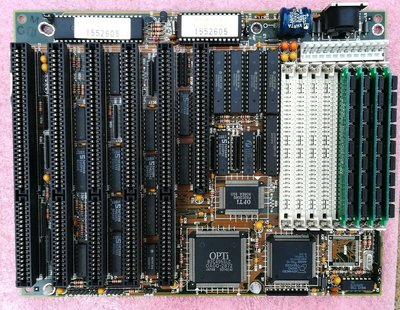

I received today an OPTI-based 386DX40 mobo markes as "364 v1.1"
this is as far as I've tested it for now, for some reason it reports a "Cyrix M6 CPU"
Anyone knows what's up with that? Maybe some jumper setting?
There is a jumper left of the keyboard controller, 2 jumpers right of the BIOS chip and another 2 on the bottom right corner of the mobo ...
I'd really love to use that 386DX mobo but that Cyrix M6 business makes me worry 🤣
Any info/help/tip is appreciated as always, TIA!

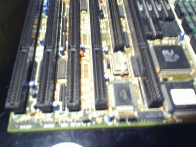

Hi keropi, that's a cute little Baby-AT board you've got! Congrats! 😁
I searched my little mainboard collection, because your board looked so familiar to me.
Well, I have similar board, but it is ALI-based (ALI M1429 A1).
Anyway, the board layout is quite similar. So I thought maybe you can make out jumper settings, etc.
and uploaded a photo of it.

hmmm similar but not quite the same - still there is some interesting silkscreen that I'd love to know what it says since the camera flash made that impossible:
I think the 2 jumpers at the middle-bottom part of your pic left of that Harris IC could have the same function as the ones located at the bottom right corner of my mobo.
It does seem a good board, that's why I want to use it 😀

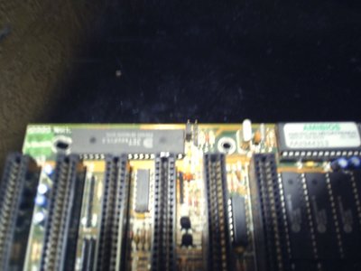

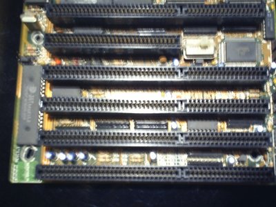

Reply 3 of 29, by Jo22
Okay, I did my best.. Sadly, my camera can't take pictures that close. 🙁
It's an older model, without mechanical zoom and stabilizer.
The room is also quite dim and a lamp doesn't help much.
Without flash or sun shine, it is very difficult to get a proper image.
I even put the board on my scanner, but the result was even more blurry.. 😢

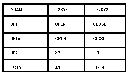

I managed to write down that chart, though.
The text next to the xtal is RESERVE/386DX (jumper, pos. to the right, 1-2)
The text next to the KBC is EXT. BAT (4pin header) and MON/COL (jumper, 3pin, pos. to the right, 1-2)
The jumpers at the front are labeled JP7 (pos. 2-3) and JP6 (pos. 1-2).
I hope this, helps. The numbering of the jumpers on the board is sometimes written in reverse.

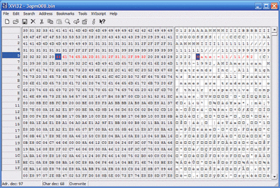

I did some more searching, this time with the BIOS string " 40-04AA-001107-00101111-111192-OP495SLC-8" and found a 486 mobo with a similar one: http://motherboards.mbarron.net/models/486vlb … /opti495slc.htm
The manual has traces of jumpers for 386 motherboards. The bottom right jumpers are for 33 or 40mhz operation. The jumper next to the BIOS are for the external battery (pins 2+3 connected if internal is used) and I assume the one next to it is for color/mono display.
I am still unsure what the one left of the keyboard controller does.
Tried various combos and I could not get the cpu to be recognizes as an AMD 386DX one. Maybe that's how the system sees it as the chipset is a hybrid 386/486 ...
I am attaching the BIOS just in case anyone needs it
Reply 9 of 29, by Jo22
Your BIOS is a bit strange to me. For example, it says it is from '87. This doesn't match with its own BIOS message ('85-'92).
Besides, these Cyrix chips weren't released until '93/'94. So how can a BIOS from '92(?) know about them already ?
Ok, maybe it has got a table about prototypes already.. But still, this doesn't feel right.

Edit: I found another BIOS for OPTI 82C495SLC. Its description also mentions 386DX40. File name is 3opm008.zip.
If you wish, I could write it to an EPROM chip for you. 😀

Seems the BIOS I have found has the same date code as yours..
Guess I have to find another one. If there is any..

It occured to me, Cyrix M6 is a 486 cpu, right? If yes then it's just weird having a 386 getting detected as 486... haven't located a newer BIOS to test yet - no idea if it's even possible to do so.
Ran some benchmarks too , the board is slightly faster than my BIOTEQ-based one:
Reply 17 of 29, by keropi
Finally decided to test the mobo before I move it to my 386DX build.
This is ~21hrs of testing with 8MB 60ns RAM (sadly 3 kinds mixed) and every memory option in bios set to 0WS and fastest timing available. I think it's all good 😀
edit:
had another look on the manual about an Opti495SLC Jo22 and I found , on the very last pages they have the correct BIOS options for various 486 and 386 cpus, and the one for the 386DX/40 is:
It is the auto-config function that made the difference, once I disabled it I get this on boot:
I also had the "AT BUS Clock Selection" at the default that BIOS loaded: CLK1/6 , I wonder what difference the correct 1/5 value makes (yes it does, in wolf3D benchmark from 23,9fps I get now 24,3 🤣 🤣 🤣 )
