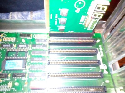

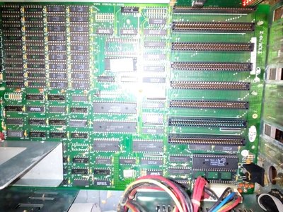

Hi, I've just bought an 8088. It comes with a 5"1/4 floppy drive and a western digital hdd (with many many more things and other PCs that I'll probably show you later in the right topic) for 50€ in total. However as you may have guessed, it doesn't POST (at least it doesn't seem to since I don't have any monitor compatible with it. I've got 16bit ISA VGA cards though). The HDD is probably making a short circuit (tantalum capacitor ?) since the psu doesn't start at all when it is plugged. But it's fine when I disconect it.
I've tried my POST card, and here is what it does :
First the POST card doesn't show any code, but apparently every voltage are fine. Then the speaker makes a clicky sound and the card shows "FF". But this is the only thing that the computer does for now.
The floppy controller had an awful VARTA battery on it, and the second ISA slot had corrosion, so I've cleaned up a bit that slot with a toothbrush and vinegar. Now it should be fine, (the motherboard doesn't seem to be damaged anywhere else, even right next to the ISA slot). What could be the problem ?
Here are some photos from the machine :
1.4 MiB
1553 views
947.86 KiB
1553 views

FF is a good sign, it normally means that all operations succeeded.
The ticking sound usually occures when the system is counting the memory.
The floppy controller is an multi i/o card, I suppose. Its battery could be for the real-time clock then.
But I'm speaking under correction here, I'm no XT expert (still learning about this matter).

Okay so I tried a trident video card ... and the PC is in fact counting the RAM !
I didn't knew it worked like that in 8088s
But the next problem is : my DIN keyboard isn't detected (the BIOS says "keyboard error") and so I can't do anything ...
This motherboard is in the AT form factor. But it seems that it's not compatible with AT keyboard. Am I right ?
EDIT : oh also this PC has a turbo mode. But oddly, in that mode at some point the picture disappears completely and I have to turn the computer off, wait for some time and turn it back on to have it working again. Is the PC overclocked so fast that it crashes ? 🤣
But I'm rather thinking that the PSU is becoming old
