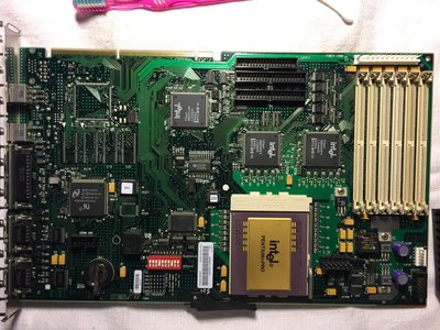

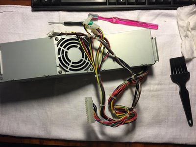

So, I recently got my hands on a Pentium Pro desktop machine for next to nothing.
It's a HP Vectra XA 6/200DT.
I'm not going to keep the whole thing, because I hate those kind of cramped desktop cases, and it was pretty scruffy anyway. Instead I've ripped out the motherboard, expansions slots card, and everything else that looked remotely useful.
Unfortunately it seems to come with some funky non standard PSU and motherboard.

PSU

HP Motherboard
I'd hate to have to save this PSU just for this motherboard, but I guess I have no choice if I ever want to use it.
Anyone recognize them, or are they as super-special HP sauce as I fear they are?
Reply 1 of 10, by Deksor
My 486 HP vectra has exactly the same PSU. In fact, I think that all hp vectras from the early-mid 90's had this PSU
However, you won't be able to fit these anywhere else than in another HP vectra ...

I was afraid you were gonna say that. A 100 Watt BEAST, in a really ugly form factor.
Reply 3 of 10, by yawetaG
Another option would be to figure out which pin does what, and then solder the special HP connector to a regular power supply. Of course, there is the possibility you will discover that even the power supply is non-standard in its voltages, but I somehow doubt that a little...

Reply 6 of 10, by GPA
It should not be too difficult to rewire a usual ATX PSU to use with these connectors. All you need is a multimeter to find out all the voltages on the original PSU wires when it is on. The tricky part may be a PS-ON signal. I recall old HP PSUs did not provide HIGH level on PS-ON pin, it was the mobo that pulled this pin to +5V from standby. If it is a hard on/off (AT-like) PSU there is no issue at all - just use a usual ATX PSU and wire a switch between PSU's PS-ON and GROUND wires after rewiring it for HP connectors. If it is a soft on/off PSU (ATX-like) you will need to find a PS-ON wire on the original PSU first. Plug it in the outlet and measure all pins against ground while the PSU is off. If you are lucky enough, there will be 2 (or more, if there is a good drain on +5V Standby curcuit) wires with +5V. One of them will be PS-ON. The PSU may actually start when you measure the PS ON pin. Or might not. You can use a resistor like 100 Ohms, which will give you a current of 50 mAmps, between these +5V and GROUND and see which pin makes PSU start. This pin will be PS-ON pin. Just don't leave the resistor connected for long. Connect, if the PSU doesn't start within a sec, it won't start, so disconnect.
If you are not lucky though, you will need to match all +5V pins on the PSU plugged to the outlet, but not connected to the mobo with +5V pins when PSU is plugged both into the outlet and the mobo. You will probably find that there is an extra +5V pin present when the PSU is plugged into the mobo. This would be a PS-ON pin.
Reply 7 of 10, by kanecvr
If you have the riser slot you might be able to mod a desktop case to fit it in. W/o the riser, the board is worthless. I thing the PSU's pinout is regular AT. Not sure tough so don't take my word for it.

It came complete, with the expansion riser card and evertything. It even worked, but I don't have space for this kind of case.
I'll poke around a bit with the PSU and see what I can find. Thanks for the tips, everyone!
Reply 9 of 10, by BloodyCactus
hp vectra pinout;
http://pinouts.ru/Power/hp_vectravl5_power_pinout.shtml
other non standard pinouts listed too for other hp models
http://pinouts.ru/Power/#HP
