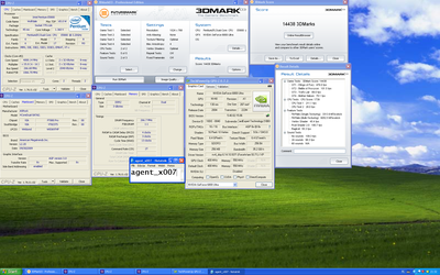

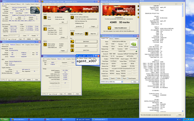

Reply 10 of 24, by agent_x007
Windows XP and 3DMark 03 :
My 6800 Ultra (stock AGP), got ~12,9k with Pentium 4 EE 3,2GHz @ 3,53GHz, and ~14,4k with E5700 @ 4GHz. So you can expect around +10% increase (maybe more - depends on platform optimisations you have now and on new rig).
1.92 MiB
509 views
Windows XP and 3DMark 01 SE (same GPU) :
~23,9k with Pentium 4 EE 3,2GHz @ 3,53GHz, and ~34,6k with E5700 @ 4GHz.
'01 SE really likes fast CPU's 😀
1.17 MiB
509 views
To ilustrate how much 3DM01SE Really likes CPU's 😁
1.22 MiB
499 views
Sadly I didn't tested 6800 Ultra on E5700 with Win 98 SE (only GX2 I own) 🙁
But seeing your results, you pretty much maxed out 3DM03 score for A64.
'01 SE score will go through the roof tho with a PDC E5700 😀

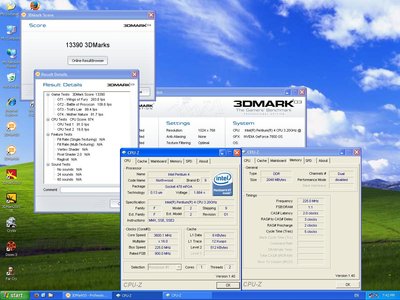

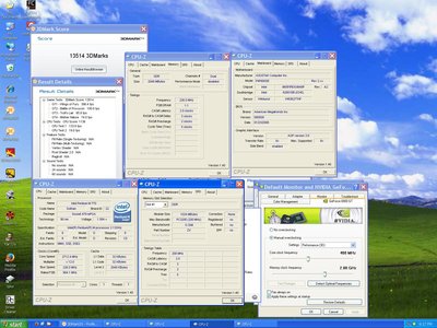

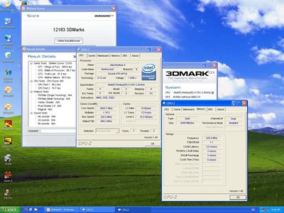

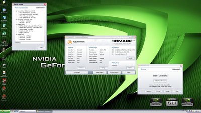

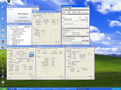

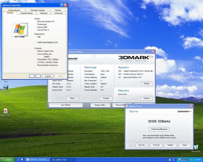

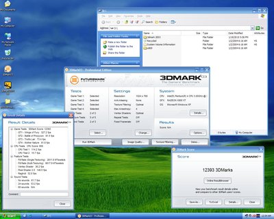

Reply 13 of 24, by Imperious
I guess I should have posted these 2 as well to back up what is being said here. I may as well put the 7800gs scores up too.
    318.94 KiB
    476 views
    Pentium M@2712 7800GS
    190.62 KiB
    476 views
    Pentium 4@3600 7800GS
    308.74 KiB
    476 views
    Pentium M@2712 HD3850
    302.26 KiB
    476 views
    Pentium 4@3600 HD3850

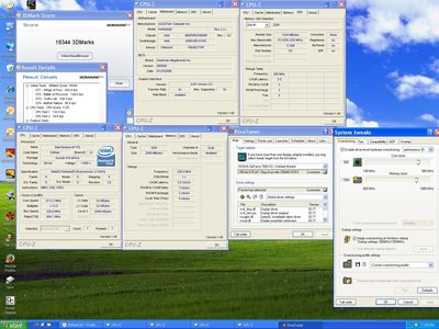

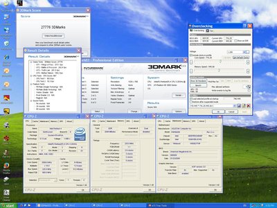

Reply 16 of 24, by kanecvr

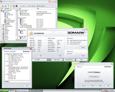

Here's some of my scores:
A64 3800+ / GF 6800LE:
246.26 KiB
455 views
P4 631 + X800XT cpu is holding the card back - pretty sure I could score 14k with this after minor tweaking and some heavy overclocking on the CPU side.
188.85 KiB
455 views
Now some of my better scores - 2x 7950GT in SLi on a Pentium D 945 running at 3.75GHz:
165.07 KiB
455 views
8800GTS + Q6600 @ 3GHz:
339.83 KiB
455 views

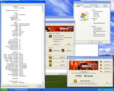

Reply 17 of 24, by kanecvr

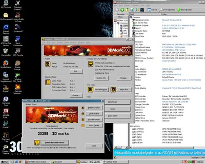

My 6800LE modded to GT (16p) seems to score better under XP then it does under 98:
211.3 KiB
454 views
211.1 KiB
454 views
