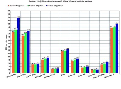

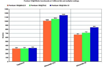

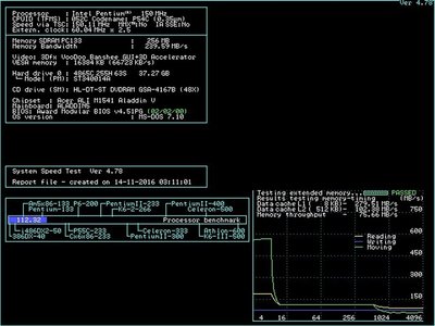

I got this p133 cC0 SY028 off Ebay a couple of weeks ago. I was doing some messing around with overclocking on an ALI Alladin mobo I got, 5ALI61 Rev F. I did get it to
boot at 200mhz but nearly everything I tried to run crashed, no surprise there I guess. I found I could run the same speed of 150mhz at 3 separate fsb and multiplier
settings, so thought I would run some benchmarks and document the results. Obviously the sdram is being severely underclocked at 60mhz and it's hard to find any information
out there about the PCI speed at 75mhz fsb, but I would assume 100fsb = 33mhz PCI and 60mhz fsb = 30mhz PCI. The video card is a PCI Voodoo Banshee.
I used Phils Dos Benchmark version 2 suite for most of these results.

Looking a bit closer at the Speedsys results, it appears to be the L2 (Motherboard cache) that shows the most improvement from 60fsb to 100fsb, also the SDRAM. The L1 cache doesn't show massive
improvements which makes sense as it's running at 150mhz irrespective of fsb and multiplier.

Really interesting results, thank you for taking the time to make up the charts and post them.
Look at how much 3dbench is effected by the increase in RAM speed compared to the other benchmarks. It is also the least-demanding benchmark in the bunch. Less pixels to push=greater jump in performance with increase in RAM speed. The idea follows suit with Wolf3D and Chris 320, and to a lesser extent, Doom. The more demanding the benchmark, the less effect faster RAM has.

mrau wrote:
win quake is software or 3dfx accelerated? i mean this result is either due to banshee power or missing DOS setup imho..
3dfx accelerated. One little detail I forgot to add. I don't see a lot of point in Running benchmarks in software mode under windows if the game works in Dos.

Thanks for Your insights. I might rerun the 3Dbench result later just to be certain I wrote it down right.

Old news to me 🤣 but yes better higher clocked FSB gave a nice boost, not much bandwidth at 60mhz and 66 isn't great but 75 and 83mhz is the sweet spot for a lot of socket 5/7 boards when the option to do so is available. SS7 Pentium and Pentium MMX have a FSB wall at 100mhz (tired 105 on a few boards and no post) but are pretty snappy on those boards.
