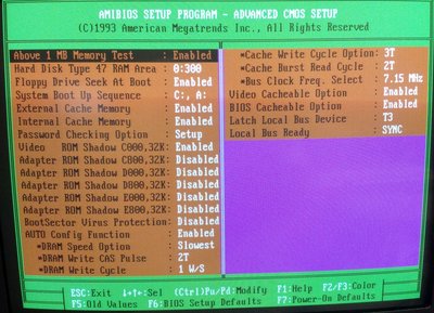

Are there any BIOS settings that control cache or RAM speed? If so, maybe try lowering them for stability.
Example, here is my 486 BIOS:
456.62 KiB
153 views
When Auto Config Function is enabled, it runs RAM at BIOS defaults. Disabled then the timings below it come into play. The two Cache options (Write Cycle and Burst Read) control L2 timings.
