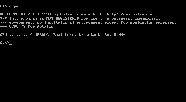

"How can I ensure I'm running in real-mode dos?"
By not loading memory managers like QEMM, EMM386 or JEMM. 😉
But if you really want to be sure, you can run programs like NSSI or WCPU (WhichCPU, by Holin) to check.
I've attached the latter program for you, since it is hard to find nowerdays (no idea where I originally got it from 😅) .
- The only other version I was able to find was an early one from about 1992 (v0.50).
    2.75 KiB
    785 views
    WhichCPU v1.2
    wcpu.zip
    24.77 KiB
    99 downloads
