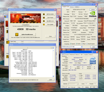

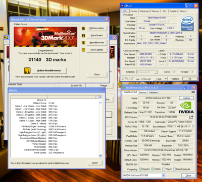

Reply 49 of 51, by Standard Def Steve
dr_st wrote:
Interesting. By how much roughly? What about multi-threaded benchmarks?
On average, 11% for single-threaded 2D application benchmarks and 20% for single-threaded games.
3DMark01 was one of the bigger wins, with the PM being 40% faster.
Pentium D 935 @ 4GHz:
542.61 KiB
602 views
Pentium M 755 @ 2.72GHz:
773.94 KiB
602 views
AIDA64 indicates that the Pentium D has faster caches than the PM, which I found interesting. I guess cache performance doesn't mean a thing when it's combined with a weak core. As for multi-threaded benchmarks, the Pentium D was able to outperform the Pentium M in every test, by 14-58%.
