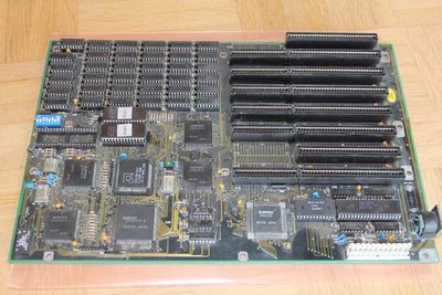

SUNTAC 80286 Mainboard help
Reply 20 of 40, by kenrouholo

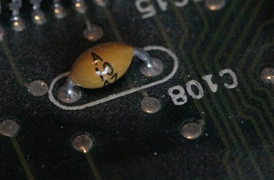

The type of cap you circled is a ceramic cap and they aren't really good types of caps for many reasons, but they also don't tend to go bad.
Your main caps are the yellow "drop" shaped things. Tantalum caps. They're similar to electrolytic caps in performance and I don't believe the construction is very different, either, though I don't know as much about the materials science side of them.
You can't test a capacitor with a regular multimeter. You must have an ESR meter. I mean you can use a multimeter to sometimes determine a bad cap, but only very rarely will a cap be so bad that you'll find it that way. It's pretty much a waste of time. You can try it with the tantalum caps if you want but don't expect much in the way of results from this method.
Edit: Keep meaning to reply and say 2 things, and forgetting to say the second thing...
What did the ceramic cap you circled act like?
It may be in parallel with other devices that throw your results off, which is fairly common "in circuit." Or is it appearing open? Maybe it has some charge on it if so. When your meter says infinite/open, what it means is "extremely high resistance" which a charged cap could potentially present.
Yes, I always ramble this much.

All capacitors act like desribed. With exception of this one
Unfortunately it is the only capacitor of this kind on the whole board so that I am not able to compare this behaviour with another one. Additionally, its the - in terms of size - biggest one - so maybe there is another explanation that both pins are not connected to each other?
Hmm, could be the faulty capacitor is the issue. Looks to be a 0.047uF 473 Ceramic Disc Capacitor, same kind used in electric guitar tone control circuits, and they are pretty common at places like Radio Shack, Should be able to find one, swap it out, and find out if that's truly the issue. Heck, could pull a mylar (the green plastic ones) if within spec....might work.

Yes a film cap like a mylar cap will generally work fine to replace a ceramic cap. It'll cost more but if you don't need a large quantity it'll be fine. It'll also be physically larger, but not overly so if you get the right one. And yes most capacitors including ceramic do have standardized codes so interpreting it that way is correct.
That said, ceramic caps aren't that useful in many circumstances. They're used because they are cheap and small. But their characteristics suck for signal paths and these are probably bypass caps, and if open of them opened, I'm not sure it's going to be a huge deal. I'm not saying it's 100% definitely a bypass cap, nor am I saying 100% that a bypass cap failure would be OK. The clock speeds in a system like this are not high so it's possible it could be a coupling cap or something even though ceramic caps aren't great for that. Just not totally convinced that cap's the issue.

you cant test capacitors while they are on the motherboard. its a false reading (your testing the capcitance of the entire circuit), you also need to be careful as testing like this, puts voltage into the circuit, you must know which side of polarity you are on if you are going to be pumping voltage out into pins that might not want a reverse voltage coming in
Reply 24 of 40, by h-a-l-9000
Rank DOSBox Author
DOSBox Author
This capacitor has such a small value that you won't see anything with a normal multimeter. On most other capacitors you can only measure something because they are at the supply rails.

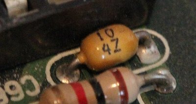

Reply 26 of 40, by Predator99

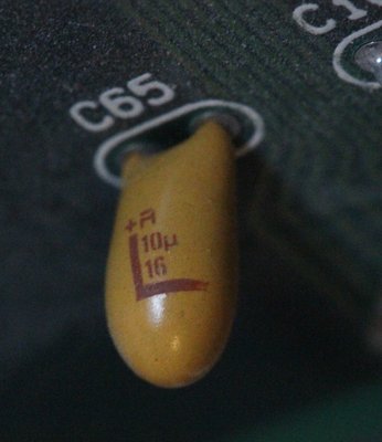

Regarding the Tantalum caps: I identified 2 different kinds...
This one: "A 10µ 16"
73.47 KiB

And this one: "A 10 Z"

Can you tell me what the characteristics are and what replacement I have to look for? I did not find anything abou these values...
Reply 27 of 40, by gdjacobs
I'm not sure what the letter code is for. Perhaps tolerance? Through hole tantalum caps aren't as standardized as SMD parts. The first cap is probably 10V, 47uF. The third is obviously 16V, 10uF.
Reply 28 of 40, by BloodyCactus
tantalums dont need to be replaced like electrolytics. tantalums dont loose thier capacitance.
Reply 29 of 40, by Predator99
So then...what is the advice? 😉 Should I replace the caps or not? I have learned the Tantalum will not fail and also not the Ceramics. Bute as far as I can see there are no others.
In the mean time I bought a replacement of the 473 with the differnt behaviour. I measured the resistance between the Pins and they dont seem to be connected on the new one, too. Therefore I think the one on the board is also OK.

The small caps are not tantalum but film capacitors. Regarding the size the '10' could be nF. The voltage is coded into the letters, but 16V+ are safe.
But in your situation these caps would be one of the last thing to investigate. If you want to swap something, start with the crystals, they can be damaged by mechanical shock. Or the 286-10 may have burned out over time when ran at 12MHz.
Tantalum can actually fail but I doubt it's happened here.
Try the diagnostic card Jo22 mentioned. You can find them as imports from various places and they are easy to find and quite cheap. Many have an ISA slot on one side and a PCI slot on the opposite side. They'll have a 2 or 4 digit display which will go through error codes and it will at some point stop and you will have a list (might need to find a list on Google if you get a cheap imported one that doesn't include a list of codes)... The problem is likely at the code it stopped on or the next code it would have gone to (which you may or may not be able to figure out).
They can go bad with heat and time and excessive ripple like standard electrolytics, but they are considered better than most other types of earlier electrolytics. I'm not saying they're the problem, just that they also aren't timeproof. Some do have liquid electrolyte. They actually are electrolytic capacitors but they are somewhat unique so people keep them under a separate label much of the time... but they do suffer from most of the same problems that other types of electrolytic do.

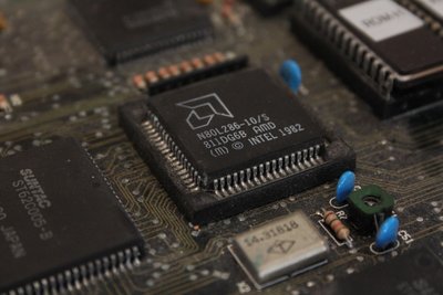

Reply 36 of 40, by Predator99
To give an update on this: Yesterday I received another very similar SUNTAC Board. It looks much worse than the other one. Dirty, very corroded and probably stored outside. But: it works! First I did was to remove the battery...
To check if the BIOS is the reason the first board does not Power up I exchanged the Chips: The new Board doesnt power-up with the old chips, but the Diagnostic card starts to count. Therefore the other board should do this, too. The old board does also not work with the chips from the new board, however...
Therefore still no idea what is wrong with the first one. But these boards seem to be very robust 🤣

Reply 37 of 40, by Anonymous Coward

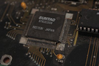

That's a pretty unusual way to put a surface mount CPU on a board. I wonder what that little plastic stand is for.
Reply 39 of 40, by Anonymous Coward
I wonder if it was a way to convert a board designed for a PGA 286 to one that uses surface mount...sort of like those surface mount am386-40 chips that came on the PGA adapters.
