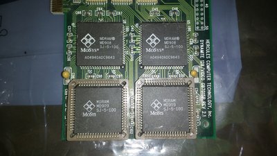

So. I recieved that ET6000 that I bought, and I had to do some soldering work.
Change a cap, and solder some components back into place, and behold, it
is working without any trouble. Gives 66.6 in 3d-bench 1.0 on a 5x86-133.
What struck me, is that with all memory populated, it reports 2mb.
I thought it was 4mb, so I need to ask if it is reporting the wrong amount.
I hope that there is nothing wrong, and it is indeed 2mb all in all.
Thanks in advance.... Picture attached underneath here.

Reply 1 of 3, by sprcorreia
Each 908 chip is 1MB. 909 is 1.125MB. Total should be 4.25MB but maybe it doesn't like to be mixed or still has some fault. You can try to remove the modules and check the card.

Reply 2 of 3, by kixs
You have two chips (MD908) with 1MB and another two (MD909) with 1.125MB. Total = 4.25MB. Although ET6000 can use maximum of 4MB.
Reply 3 of 3, by brostenen
Hmm.... That might be what is wrong. I will try and remove those two chips and see what will happen.

EDIT:
Yeah.... Googling the card with image search. None of the cards have mixed memory chips.
100% confident that I did a good job on soldering after all. Bringing this card back to life.
