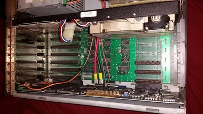

Reply 1 of 24, by torindkflt
I have an AT&T PC 6300 (Rebadged Olivetti M24) with some 16-bit slots in it, proprietary of course. The 16-bit extensions on the slots are literally ALLLL the way on the opposite side of the motherboard from the rest of the ISA slots. 🤣
The attachment 20170315_212159.jpg is no longer available
Reply 2 of 24, by Jo22
Awesome machine! Thanks a lot for the picture! 😁
