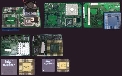

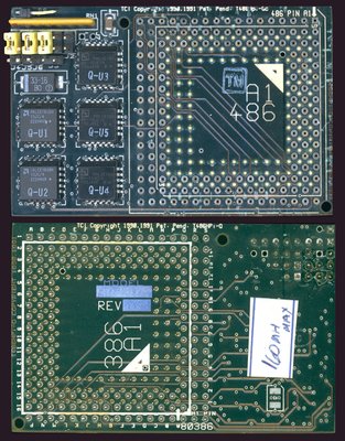

Attached are images from a test I did using a Transcomputer 386-to-486 upgrade module. I first used the module intended for a Compaq called the 486HPi, and one intended for an IBM called 486PX. A few years ago, there was an individual in Washington state selling these on eBay from retired systems. Seems like he had about 2 dozen each and they sold quick. I am surprised that nobody else on Vogons has posted test results from these. Later in this thread I'll demonstrate using the Transcomputer 386 upgrade module with an AMD Am5x86 running at 160 MHz on a 386 motherboard.

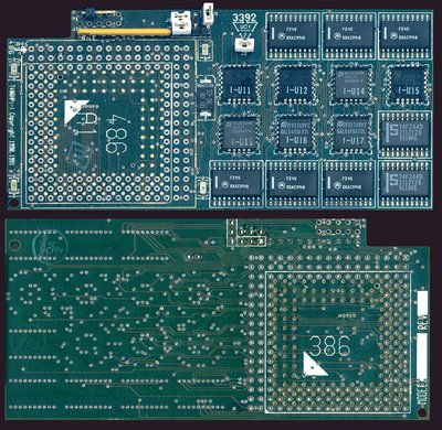

Here is a scan of the two modules. Note that all images can be clicked for higher resolution versions. All images are cropped/compressed/resized.
720.04 KiB
2993 views
983.24 KiB
2993 views

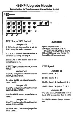

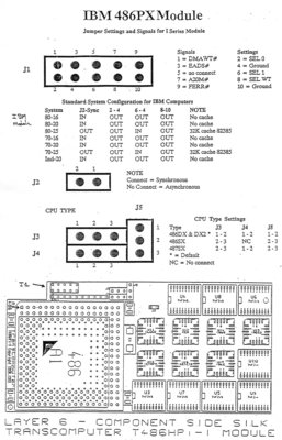

Here are their jumper sheets.
405.46 KiB
2993 views
697.38 KiB
2993 views

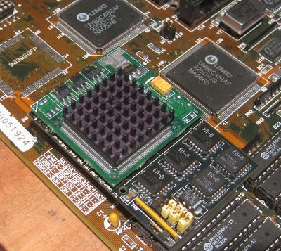

My adventure into 386 upgrades started in the mid-90's when I purchased a second-hand 386 board from a friend. It had an AMD 386DX-40. For a long time, I always thought this was the fastest CPU for the ole 386 motherboard. Much later, I later realised that there was a Cyrix 486DLC which also ran at 40 MHz but contained 1 KB of on-CPU cache.
244.14 KiB
2991 views

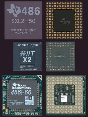

More time passes and I was informed about the Texas Instruments 486SXL, which is nearly identical to the 486DLC but has an increadible 8 KB of L1 cache. Naturally, I wanted to take the machine to the max, so I upgraded again.
430.44 KiB
2991 views
More time passes and I was able to source a clock doubled version of the 486SXL-40, called the 486SXL2-50. I paid the $25 and upgraded yet again. I didn't really like how it ran with a 25 MHz FSB compared to the SXL-40, with a 40 MHz FSB. Obviously, the memory and L2 cache run slower with a 25 MHz FSB. However, recent testing has revealed that this is of little consequence compared to the faster CPU speed of 50 MHz. Some boards really shine with the SXL2-50, while others show only marginal improvement above the SXL-40. I am still working on a large 386 chipset benchmark comparison with all these high-end CPUs, so stay tuned.

There was also a low voltage version of the TI486SXL2 which ran at 3.6 V. It came in PGA168 and QFP144 formats. Shown above is the QFP144 variant placed onto a PGA132 upgrade module, which also contains a voltage regulator to drop the motherboard's 5 V down to 3.6 V. It is rated for 66 MHz (clock-doubled), but it also runs well at 2x40, or 80 MHz. The QFP144 to PGA132 upgrade module is difficult to find, however the PGA168 CPUs are readily available even today. For this reason, it would be nice if there was an upgrade module which converted PGA168 to PGA132, specific for the 486SXL2-66 PGA168, e.g. Custom interposer module for TI486SXL2-66 PGA168 to PGA132 - HELP! Unfortunately, the SXL2-66 would not work in the Transcomputer module.

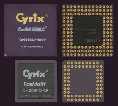

Some 386 boards have built-in support for enabling and supporting cache coherency between the DLC/SXL's onboard L1 cache, while some require software or hardware work-arounds, e.g. adding an external NAND FLUSH circuit, using the BARB register to invalidate the cache at every hold, or merely enabling via software L1 cache and opening up the cacheable region. Thus far, all my motherboards work with the L1 cache of these CPUs using software to enable it.
There was also a Cyrix 486DRx2 which rated speeds of 50 MHz and 66 MHz. These chips supposedly have the cache coherency circuit built into the unit. Unfortunately, they only have 1 KB of L1 cache. Is a Cyrix 486DRx2-66 with 1 KB of cache faster than a Texas Instruments 486SXL2-50 with 8 KB of cache? They are pretty darn close, but it depends on the motherboard. On my VIA 481/495-based board, the SXL-50 is a good bit faster than the DRx2-66, however on my UMC 481/482 board, the SXL2 needs to be run at 55 MHz to catch up to the DRx2-66. On my SiS 310/320/330 board, the DRx2-66 is faster than even the SXL2-55. More on this chipset vs. CPU comparison in the months to come.

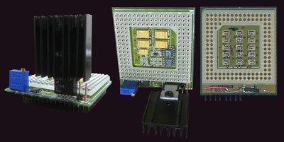

Was this the end of the road for 386-to-486 upgrades paths? Apparently not. I've been sitting on these Transcomputer modules for a few years now and haven't tested them until recently. They didn't come with jumper headers for CPU selection, so I added them. They send 5 V to the CPU, so if you are testing these, test a 5 V CPU. I originally tested the Cyrix DX2-66 on my UMC 481/482-based 386 motherboard using the smaller 486HPi module with jumpers set for a DX2. The system powered up. It could enter the BIOS to display the screen summary, but I could not navitage the pages. This motherboard has a "MR BIOS" brand BIOS in it and thinks the CPU is a Cyrix 486DLC. I beleive this confusion is why I cannot navigate the BIOS pages. Not important as I had already set the CMOS settings accordingly. To my surprise, the 5V Cyrix DX2-66 ran beautifully and the L1 cache was already enabled by the BIOS. Next I tried a Cyrix 486DX4-100, however I did not have an additional interposer module setup to run other chips.

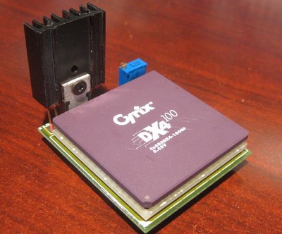

I took a VRM interposer module which came with a Gainbery IBM 5x86c-100HF and modified it to be a variable voltage VRM. I figured this would come in handy since there are Cyrix 486 CPUs which run at 3.3, 3.45, 3.6, 3.7, and 4 V.
332.45 KiB
2990 views
228.1 KiB
2990 views
The Cyrix DX4-100 also ran beautifully with L1 enabled. When I installed an Intel DX2-66, the CPU ran fine, but the L1 cache was disabled as determined by cachechk and chkcpu. I was also able to browse the BIOS with the Intel DX2 installed, but there was no option to enable the L1 cache. Does anyone know of L1 cache enabling software for Intel/Cyrix/AMD DX2/4 CPUs? All I could think of at the time was SetMul.exe. I ran setmul.exe L1E. The program spit out a pretty nasty error, but according the CHKCPU and CACHECHK, the L1 cache is enabled. I confirmed L1 was working by running varous benchmarks.

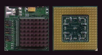

I figured it was about time to get serious and pulled out my Evergreen AMD Am5x86-133, which is already on an VRM module.
422.65 KiB
2990 views

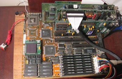

Here is my setup. I am running an Am5x86-160 with 32 MB RAM, 256KB cache, Diamond SPeedStar 64 (Cirrus Logic CL-GD5434 w/2MB), Adaptec 1520B SCSI, 3Com Etherlink III 3C509B, and a generic Sound Blaster Vibra16.

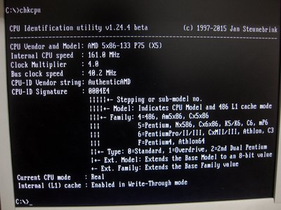

CHKCPU also records the correct information
213.65 KiB
2990 views

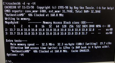

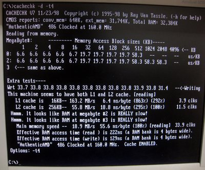

Cachechk indicates a step at 16 KB, confirming that the L1 cache is working.

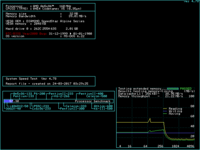

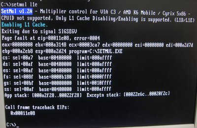

Interestingly, Speedsys seems to think that L1 cache is not enabled. Can someone explain this and explain the strange spike on the graph? I found in the past that Speedsys can have problems with odd CPU configurations and I tend to trust cachechk more.
12.56 KiB
2990 views

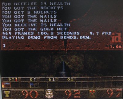

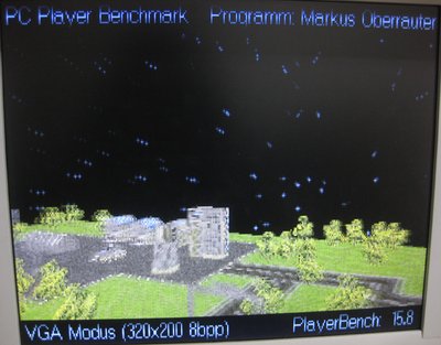

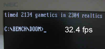

Below are the results from Quake (timedemo 1), DOOM (timedemo 3), PCPBench (vga mode), and 3DBench.
200.16 KiB
2990 views
27.13 KiB
2990 views
186.96 KiB
2990 views
160.68 KiB
2990 views
How do the results of the 386-to-X5-160 compare to results of an AMD X5-160 on a PCI 486 motherboard? For simplicity, I will use "Quake 386" to refer to the results of my UMC 481/482-based motherboard running the AMD Am5x86 (x5) at 160 MHz and "Quake 486" to refer to the results on my UMC 8881/8886-based PCI motherboard.
Quake 386 = 9.7 fps
Quake 486 = 17.3 fps
DOOM 386 = 32.4 fps
DOOM 486 = 64 fps
PCPBENCH 386 = 6.1
PCPBENCH 486 = 9.6
[using VESA Modus 100 640x480 8bpp LFB]
3DBENCH 386 = 55.5
3DBENCH 486 = 94.1
Ideally, I would also want to run the PCI 486 motherboard with the same ISA graphics card (CL-GD5434) and compare again.
However, what I can estimate now is what performance the Transcomputer system has to that of the PCI system with a given CPU. From these results, the Transcomputer Am5x86-160 has the gaming performance of a PCI-based 486 system with an Intel DX2-66-WB. Actually, it falls somewhere between an Intel DX2-66 and a DX4-100. The ISA graphics is really holding it back. For non-graphics benchmarks, I suspect the results are a lot closer to that of an Am5x86-133, but I've yet to test this. It would be really interesting to see a test done with one of those VLB-based 386 motherboards.

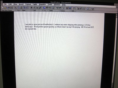

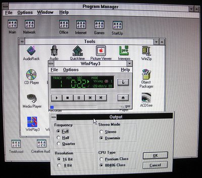

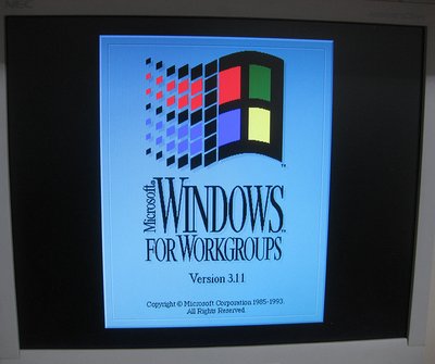

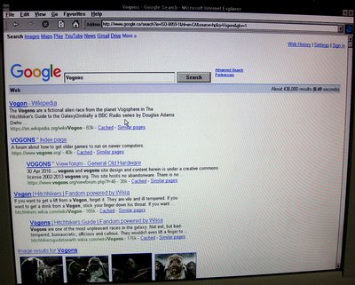

Another good test to run is Windows 3.11. If you have having cache coherency issues, it will often show up while booting Windows or from within Windows. I did not have any problems. Here are the results.
207.37 KiB
2990 views
315.77 KiB
2990 views
With the SXL2, if the L1 cache isn't playing nice with the system's cache controller, usually you will have DMA issues with sound cards and crashing (this, by the way, is fixed by setting the proper non-cacheable regions). So with the Am5x86-160 installed, I opened Winplay3 and played a mp3 file in stereo, 44 KHz, and 128 mbps without any down sampling. I ran it for 2 minutes without a single skip.
366.32 KiB
2990 views
Wanting to test my luck, I opened up Corell Word Perfect 6.1 and typed away. There weren't any skips. Word Perfect openned as if there wasn't a CPU hogging mp3 being played.
460.77 KiB
2990 views
Surely if I did a search with Internet Explorer 3 there would be skipping...
650.56 KiB
2990 views
nope! And IE opened and ran Google Search as if I was running a multi-tasking OS. I was shocked.

I also tested the other Transcomputer module - IBM 486PX. This is a much larger module and rises above the first ISA slot. Intel DX2 or DX or SX chips would not work properly with this module. It POSTed but couldn't run anything. I suspect it has something to due with the L1 cache being disabled by default. The Cyrix DX2/4 ran just fine with it though. The performance results between the two Transcomputer modules were the same. DOOM scored 3077 in 486PX and 3071 with 486HPi. The Cyrix DX4 seemed to run fine at 120 MHz and runs quite cool in comparison to the other CPUs.
I wish I had bought more of these 486HPi modules. I had no idea it would work so well and was so rare.
