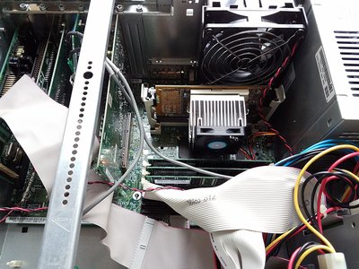

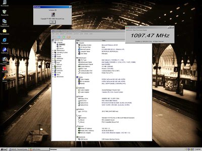

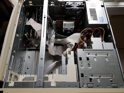

Reply 6 of 6, by oeuvre
Works like a charm! See attached pictures. Played around with some N64 emulation and it runs much much faster.
