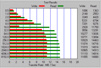

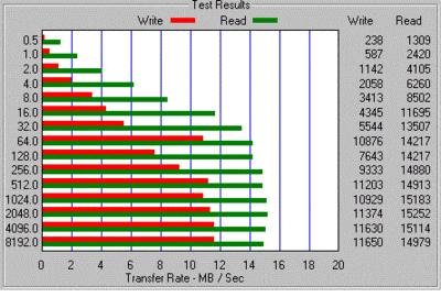

Thought it would be interesting to benchmark the two drives (using ATTO under the Win98SE install that was on the existing hard drive). As expected both beat the original 640mb Quantum Fireball HD which had a max transfer rate of 2.5MB/s, however the original HD is faster than the CF card at 0.5K and 1K writes.
For reference my CF card is an 8gb PNY Elite Performance 80MB/s card (the only 8gb card I could find new) and the SD card is an old-ish Samsung Pro 8gb SDHC.
This is the CF result
The attachment CF.gif is no longer available
This is the SD result
The attachment SD.gif is no longer available
I'm guessing that the IDE controller is the limiting factor at higher file sizes, so was surprised to see the SD card come out on top. Something makes me think the CF card should be more reliable in the long run though?

The million dollar question: Partition alignment?
If not, try benchmarking the CF again with the partition properly aligned. You'll be surprized 😉

Good question. No, I've not aligned it (yet). The SD card wasn't aligned either though, so I thought it was a fair comparison.
My (limited) understanding on alignment is that the flash card probably uses 4K blocks internally, so I should format it along the same lines to speed things up - is that right? Windows 10 diskpart should allow me to do this?
I only have a retail copy of Win 95, so will have to use FAT16. My plan for the system is to dual boot NT4 and have 2 x 2gig FAT16 partitions for Win95, and then 1 x 4gig partition for NT4. Any advice on getting all of those partitions aligned properly?

Unfortunately partition alignment is only sufficient for NTFS partitions since in case of NTFS meta information is part of the file system (MFT). But in case of FAT16/32 the data blocks can start unaligned even in case of an aligned partition. So you would need careful calculations of Root DIR + FAT(+FAT copy in case of FAT32) sizes that are disk/partition size dependent.
If you want to avoid manual error prone calculations you can try RMPrepUSB:
http://reboot.pro/topic/16783-rmprepusb-faste … -memory-drives/
