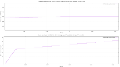

Harekiet wrote:
Slightly offtopic but seeing as you're doing sountblaster tests
I've wondered about the amount of processing time and buffering the soundblaster DSP has.
How soon after a sample is read through DMA does it appear on the output. Is there some small fifo in there to allow for a bit more output to cover the time to restart the dsp after an irq.
To answer this question, my test program shows that the FIFO is somewhere between 16 and 20 bytes large. But only if you use the SB16 DSP commands that enable the FIFO. If you use the FIFO-disabled versions, or any pre-SB16 commands, then it only buffers 1 sample.
Creative Sound Blaster 16 AWE 64 PnP - SB 16 DMA single cycle DSP test, 4000Hz, 4000 bytes, FIFO on.start.png
23.32 KiB
605 views
EDIT: The 2-byte jumps seen in the snapshot are probably an artifact of not recording the DMA counter fast enough.
EDIT: Just ran the program on the old Compaq (ESS688 chipset). Sure enough, the graph shows a 64-byte FIFO load for SB compatible commands and a 256-byte FIFO load for ESS688 extended mode commands.
EDIT: Looking at the 4KHz FIFO on SB16 test, the AWE64 card seems to have a 20-byte FIFO, which it fills to 19 bytes at the start.

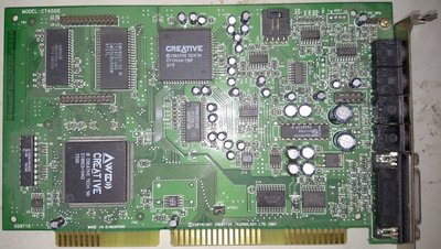

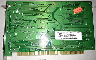

Okay, here's is the first card I am testing with the newest code.
This is a CT4500, which is a "AWE64 PnP Value" according to Creative's web site.
756.86 KiB
559 views
Bottom side
1.29 MiB
559 views
Top side
Testing is in progress now.
EDIT: The latest DOSLIB commit contains the full test results.
