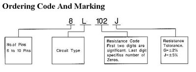

I did some deep diving in old electronics catalogs and I managed to decode the part numbers for this thing.
In the FIC Manual "RP 0Ω 8P4R"
RP = Series (of Yageo Part)
0Ω = Zero Ohms (Duh)
8P = 8 Pins
4R = 4 Resistors

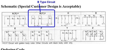

In the Yageo Catalog "8B000J"
8 = 8 Pins
B = B Type Circuit
000 = Resistance code. (It equals zero.)
J = Tolerance = +/-5%

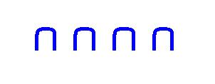

Zero ohm resistors so the part is literally 4 jumpers inline.

I guess my description wasn't clear enough.
It's 4 non-connected jumpers in one inline package.
This is about what it would look like without the plastic.
3.44 KiB
364 views
The only thing that holds them together is a lump of plastic.
They don't need to be attached to each other to work.
That construction was probably for convenience and/or to avoid configuration mistakes at the factory.
You don't need to buy anything.
You can make them using an appropriate diameter wire and a needle nose pliers.
If the wire size is good a paper-clip or some solid copper wire should work fine.
A bare wire there shouldn't be a problem. If it bothers you then heat-shrink the exposed part.
