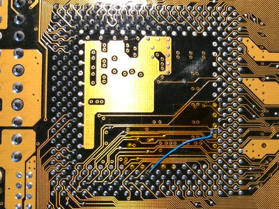

The title says it all! Following a vague post on k6plus.com regarding a simple modification to correct the "slowness" issue when paring K6-2/3 "plus" variants with Aladdin V rev G Northbridge equipped P5As (rev 1.05 & 1.06), I went ahead and tried this on my P5A rev 1.06 -- so far the results look promising!
The post I saw is here: http://www.k6plus.com/phpBB3/viewtopic.php?f=3&t=2340
To attempt this myself, all I did was use a 1K resistor to pull WB/WT# (pin AA5) up to Vcore 3.3v at VCC3 pin AJ19.
So far the only test I've done is run Quake 2 using 3DNow Software 800x600 mode with a K6-2+ @550MHz installed, and compare to my MVP3 based K6-3+ 550MHz machine with the exact same Quake settings, 98SE, identical video cards and driver version. I get 19.8 FPS on the modded P5A K6-2+ and 16.1 FPS on the MVP3 K6-3+. Considering the K6-3+ on the MVP3 board has double the on-die L2 cache, my P5A outperforming it even slightly seems to be a good indication that it isn't being hampered by the "slowness" hardware bug that effects rev 1.05 and newer boards.
I have no idea what the actual "bug" is, but this seems to indicate the ALi M1541 rev G Northbridge may not be asserting WB/WT# correctly--either poor timing or not at all. Somehow simply forcing that input high seems to work around the issue... I'm not sure if there are any side-effects yet, but so far the system seems perfectly stable.
Having just got back into SS7 since the 90s, I don't have a collection of benchmark utilities installed yet to perform a more detailed comparison. But considering Quake2 seems to play just fine the bug appears to be a non-issue now. Prior to the mod I was getting about half that frame-rate.

UPDATE: Here's a picture of the mod. I used a SMD resistor but an axial resistor would work fine too. Just be careful not to accidentally bridge to any adjacent pins or vias. It's a little difficult to see in the picture, but I used Kapton tape to help prevent any shorts.

I am no electronics whizz, but are you saying that you just have to solder a 1 k ohm resistor to bridge the 2 cpu socket pins you have outlined above. If so that would be great news. I have P5A versions 1.05, 1.06 and 1.04. So I could test the relevance of activating the defective chipset tagram with a K6plus cpu.
A pic of the two pins on the back of the circuit board would be useful with orientation shown.

Exactly, just tying two pins on the back side of the motherboard with a 1K resistor is all that's needed.
It was after midnight and I've been struggling with a head cold so I didn't bother getting any pictures yet. I'll post some later tonight to help illustrate.

Nope, I'm not certain. But since the CPU's I/O is in the 3.3v voltage domain, and the WB/WT# is an INPUT pin, I assumed VCC3 to be the correct power plane to use.
I couldn't say about the BIOS mod, but that's an interesting prospect. However, assuming Asus was aware of the issue and blamed it on a hardware bug, if it were fixable in the BIOS wouldn't they have offered a BIOS update to fix the issue?

Wow! Amazing news! I have most revisions but also the 1.05 P5A/B and 1.06 P5A, will certainly test this! Can't i simply use a wire for this or will it destroy something (sorry, don't know anything about those components). Would be nice to have the latest and fastest revision with a ''+'' cpu and also 512mb fully cacheable ram.

I'd not recommend directly wiring without the use of a resistor. I haven't looked at the M1541 datasheet (assuming one is even available), but if the chip's I/O pins are of the open-collector or MOS family (likely) as soon as that pin leaves a high-impedance "off" state and tries to assert a "low", the M1541 would almost certainly be damaged.
The 1K resistor is used as a current limiting device that allows the M1541 to still pull WB/WT# low without damaging anything.

I just updated my original post with a picture of the mod.

Thanx for adding the picture, makes it a lot easier.
