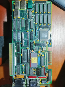

I just got a Tseng Labs ET3000AX VGA/EGA card and popped in in my Slot 1 Gigabyte board and while I get an image for BIOS once it loads into DOS there is no image. This motherboard's BIOS has a setting to switch between PCI or AGP VGA at boot.... but not for ISA -- is this the problem? Or do I need to set a certain IRQ to LEGACY ? My board is a 6BXC. There are several dip switches on the card as well but I can't find documentation on them.

it should work. its likely your dip switches are wrong. can we get a good image of the card and of the switches?
Reply 3 of 8, by infiniteclouds
First image is a picture of the same card -- but not mine -- so the DIP switches are in a different position on it.
pYTw57w.jpg?1
"It should work without BIOS setting. Is the message "Loading DOS..." still displayed? After the initial screen with the memory check there maybe a switch of display mode. Did you try to readjust your monitor? Have seen this with my ET3000. After connecting another monitor the image was there.."
Never reaches DOS. It doesn't drop the signal either, since selecting D-SUB input doesn't give a "Cable not connected".

I've tried
- VGA Configuration - (VGA-Card as primary Adapter, MDA-Card as secondary Adapter) […]
Switch Setting !! Type of Display attached and Initial Mode Selection
SW1 SW2 SW3 SW4 !! Primary Display ! Secondary Display
on off off off !! Color 80x25 (IBM 85xx) ! Monochrome (IBM 5151) or None
off off off off !! Multisync analog Monitor ! Monochrome (IBM 5151) or None
and neither work... as soon as it loads to DOS I do get a pop-up from the monitor OSD saying "Suggested resolution..." ...perhaps this video card simply does not work with LCD monitors.

I do. However, I just reloaded optimized defaults for BIOS, then reset data configuration in PNP/PCI settings where it automatically assigned several IRQs to Legacy and now it works -- I'm using SW1 on and the rest off.
