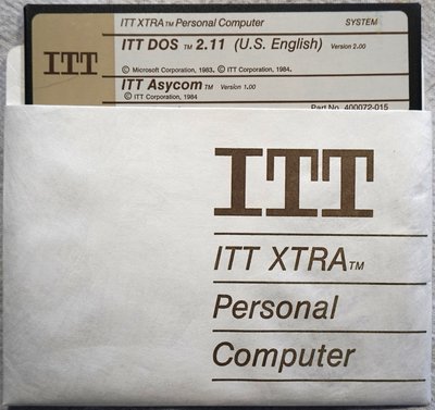

Just to help visually this is what an ITT DOS diskette would look like: (this one being my v2.0 disk)
